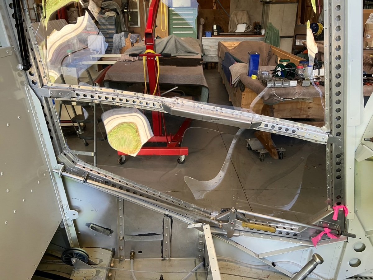

  1. The pink ribbon is to keep from walking into sharp door corners. IMG_2681.HEIC

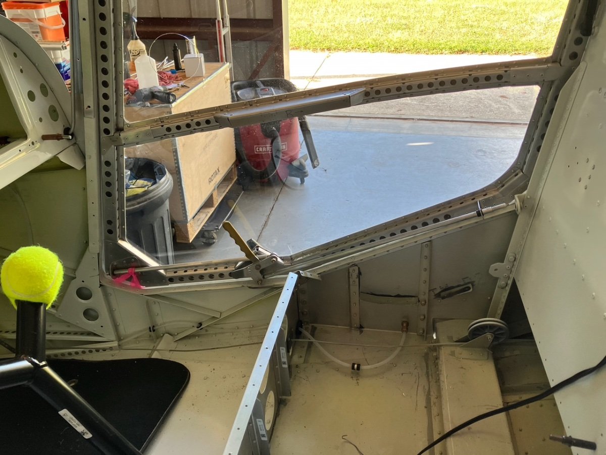

  2. IBob, here is a recent photo of one of my doors showing the kit supplied leading edge latch.
  3. IBob, My thinking exactly-very important to get the leading edge pulled in tightly to the fuselage. Thanks again for the idea regarding the tweeking of the taper and radius of the latching rod.
  4. Good idea on the rod tips, I'll think about that.
  5. Hello IBob, Thanks for getting back to me. Yes, I can fabricate them using his experience, particularly regarding the size of the curved lexan on the partial upper panel. But, if someone had sketches, notes, and general advice regarding their experience, it could save one a lot of effort. I enclosed a couple of photos of my attempt at making a 3-point door closure mechanism, the idea was from a photo of a Savannah I saw on Recreational Flying. After a good week of making a lot of parts that didn't fit, I finally got something that works quite well. I decided to keep the kit supplied Dzus type cowl latch in place--you know, belts and suspenders:-)

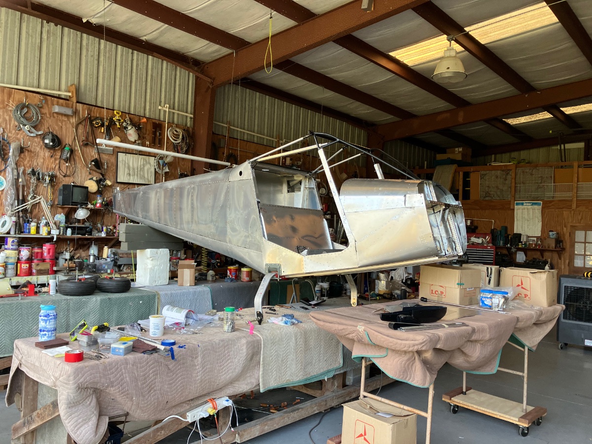

  8. Thanks old man emu, I will eventually learn the protocol. All of the other subassemblies are done and waiting to go to the paint shop along with the fuselage, which is getting close. But, I can't visualize how the flap jig is attached so as to set the angles initially. I guess the wings, flaps, and ailerons need to be mounted before this is even considered. IBob, your description of the SF341 acting merely as a pivot is an elegant and succinct explanation immediately understood-thanks again.
