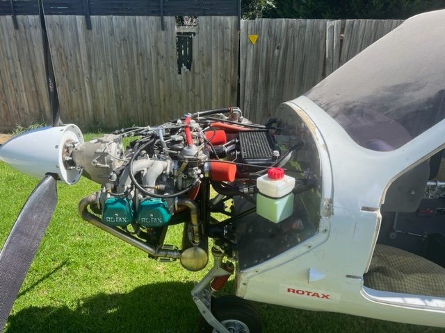

  7. In the middle of our MARAP application, 5 months in, just about 20 hours on the beast. Flies like a Jabiru 160 with a bit more power. Cowling mods finished , Got the water and oil temps up to a reasonable level, Blanking off the top cowl openings seem to have given us about 5 knots, But that may be wishful thinking I cant really see where that could have come from ( better engine temps maybe) . Someone asked me why I hadn't just changed to E24 Reg. I couldnt give an exact answer, so looked it up in the technical manual online. Now I am more confused than ever. The Jab 160c is a certified aircraft. Needs Marap for modifications. OK , Doesn't actually say that But OK. . However Page 6.1 section 8 through 9 goes on to explain the process to having it E-LSA registered. Does anyone actually KNOW , according to the Tech manual , Why, when I have no intention or requirement to teach in the aircraft, have to go through this complex process. It's difficult to understand and I fear that I have bitten off more than I can chew. I'm close to walking away from it and the RAA.. Just too difficult to deal with... Cheers, G

  11. Thanks for the comments. I appreciate it. The water temp only gets above 80c with a full power climb to altitude. Oil temp is in the green but only just.  I can block the air intake off of course.  I have limited the air intake at the front of the cowl by 50% as that is only air for the cylinders and carbs. (carb temp is about 24c)  t I'm going to wait for summer before I make any other alterations. see what its like at 30c

    1. skippydiesel
      skippydiesel
      From the photo (on its side) showing cowling/air inlets it looks like you may have overdone the incoming air. What do the top/bottom scoops feed air to?
      On my last aircraft, ATEC Zephyr/912ULS, I restricted exit air during the cooler months. I just made up a very light weight aluminium plate that covered about 80% of the exit air hole. Probably went through 3-4 versions (started large & progressively reduced plate) until I was happy with all the temperatures.
      Yeh! In Australia we really need to focus on our long hot summers, with some sort of fairly easy winter flying temperature fix.

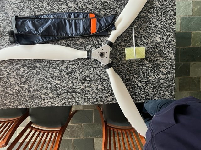

  21. A friend has asked me to sell a 3 Blade pusher prop, with hub , unused, The box says it came from Ukr. But the owner died before fitting it. He's looking for $ 1500 or thereabouts. I have it here at home , so I can answer any questions. Can post anywhere, Cheers. G
