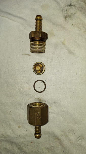

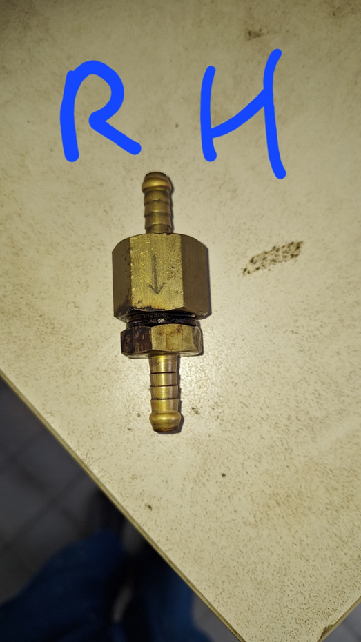

    I have now removed the two Fuel Non Return Valves from my Gazelle.
    On draining both fuel tanks prior to removal of NRV's I could see that they were allowing fuel to backflow to the lowest level tank so clearly the "non return" function was not working.
    On inspecting the simple internals I find that the flat fibre (?)disc has bent in the direction of flow - hence not sealing on backflow. The small fibre (?) sealing washer is also allowing a small amount of fuel to leak out.
    Next job is to try and source replacements/parts?
