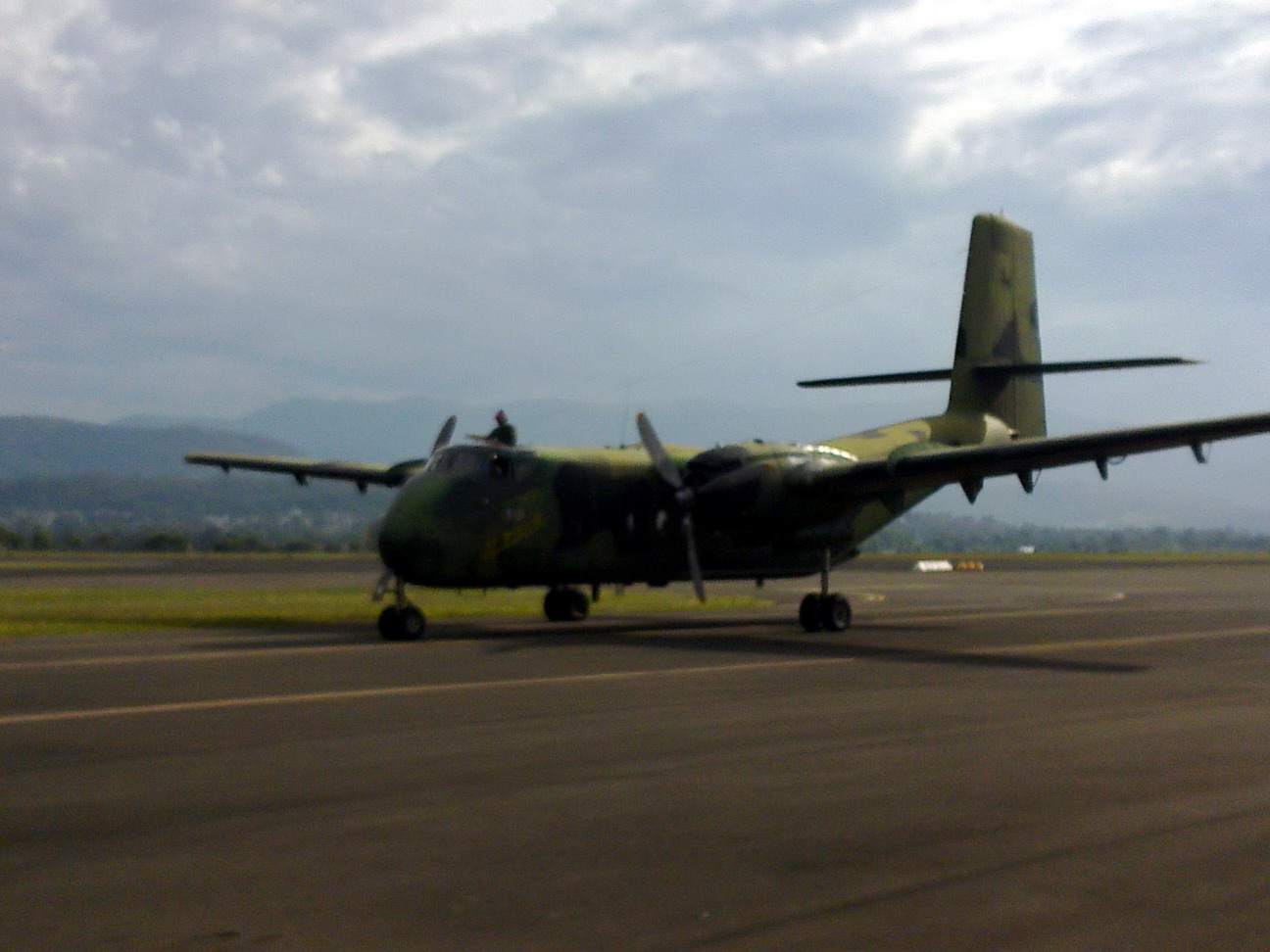

One of two caribou has arrived at Albion Park today to become part of the HARS fleet [ATTACH]12477[/ATTACH]
