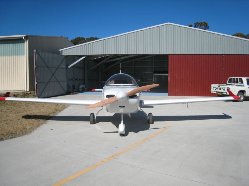

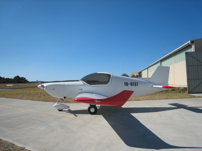

  6. ................ and successfully lands back on the ground too! Our Sierra, which we have been working on for around two years, finally took to the sky today. We were going to test fly it ourselves, but after our main instructor at Moruya offered to do it, we decided that wasn't such a bad idea. After some high speed taxi trials, a few lift-off, fly 100 metres and land, a slight adjustment to the stabilator, he did one quick circuit. The only problem was the stick had limited right travel because it was hitting his leg. Otherwise, he said it felt great to fly. We will rectify the stick, and off we go again. This may not be until after xmas however. We have been plagued by a series of delays on this project for several months now (eg, Jab had an engine recall on a batch of engines), so a little more time won't matter. Here are a couple of photos. We still plan to add some sort of red stripe/s to the side of the fuselage and tail. At the moment with just the red winglets, it looks a a bit like a certain airline fleet, and we briefly considered painting a upturned road kill wombat on the tail just to set it apart. Jeff

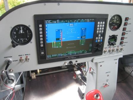

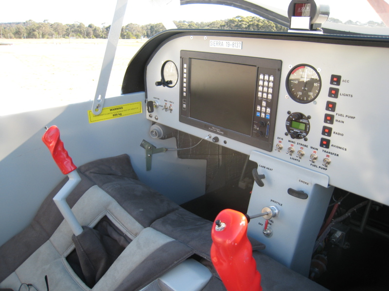

  11. Yes John, the EFIS can be set up to have 9 pre-programed screen options, which can all be custom made to what you want. The engine management displays can be designed into these, and individually configured, eg, various options for tacho placement, size, analog/digital display etc, and different for each screen if desired. The various screens are selected using the buttons on the right. As noted, we used the original centre fibreglass piece, but modified it to suit the different panel. Jeff
  12. I think I can finally upload a photo of the panel for our Sierra. When the front top deck is on, the panel sits a few inches under its cover. Jeff

  15. I don’t know if you’re still wondering about a glass cockpit, but my mate and I recently installed one in our Sierra 100 we are building. It is the MGL Odyssey EFIS (http://www.lightflying.com.au/Stratomaster%20Pages/Odyssey.htm). We recently fired up the system, and although we have not properly set it up yet, it seems to work OK (it showed us were the shed we are building the plane is, and we were pleased to see that we were only subject to 1G). The only back-up instruments we have installed are an altimeter and ASI. It does all sorts of fancy things, such as linking with the radio etc. Learning how to operate it successfully may take a little time, but it seems fairly logical. We have the engine on order, so haven’t wired up the sensors yet. But what happens is that they go into a sender forward of the firewall, and then one cable goes back to the EFIS. With six CHT sensors, six EGT sensors etc, glad all those wires don’t need to go through the firewall. Apparently it can easily be linked to an auto pilot, which at this stage, we are not installing, but this may be a project for the future after we get the plane in the air. Because of the size of the EFIS panel (which has a 10.4” screen) we got Garry to supply a 2mm aluminum sheet for the instrument panel instead of the standard fiberglass panel. We then cut it to shape. I took a photo of the instrument panel today, but how do I insert it here? Cheers Jeff
