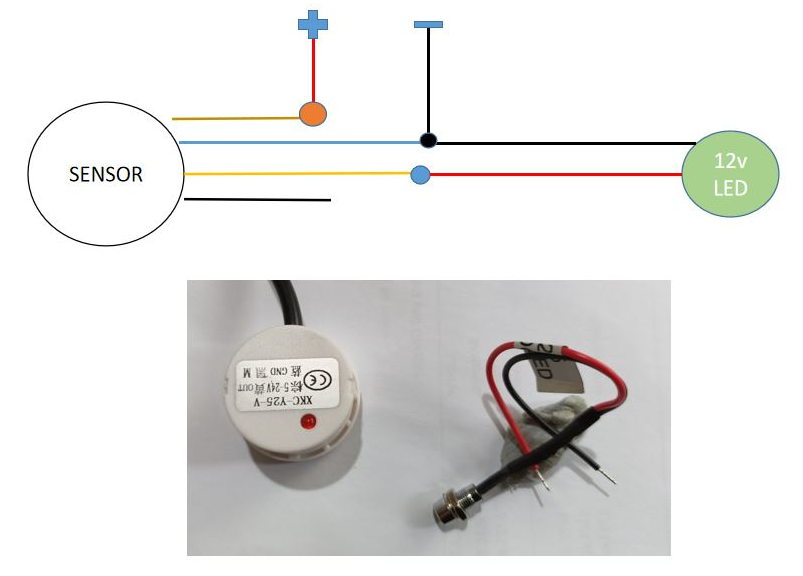

I have been working with these sensors for some time but always through a small Arduino driven multi function display. I realised that a very cheap 12 v system could be used. The sensors are placed around the 5 litre level and are set to display a green LED all the time fuel is present. That way if the system fails the LED goes off. If the Black wire, on the sensor, is connected to Positive the light will be ON if there is low fuel. (A Red LED could then be used). If the Sensor cover is removed a small trimming screw is available that needs to be adjusted to allow for tank wall thickness. I have a 3d printer file available for a plastic holder that can be stuck to the tank and the sensor slid in. The sensor is available from many places. As example here. The LED was from Jaycar. They also have larger ones if this is too small. Total cost under NZ$20 per tank. As it is 12 v the frame can be used for Earth so only minimal wiring is required. As well as the wing tanks one could be added to the header as back up to the current system.
@lyle janke Looks like the same sensor- there is probably only one company producing these. They come in range of different versions. I have to say it looks a bit expensive at US$129.95. The actual sensor is of the order of US$5-10.
These might be better as they incorporate a relay so you could simply add lights next to the existing warning light using the relay contacts. They were not around when I started.
These.. Currently integrating them into a combined display of Carb Icing prediction and flap display. (I have electric flaps). I use an Ardunio NANO. The sensors are a little sensitive to set up as you need to adjust a small screw to allow for the thickness of the tank. They are capacitance based so your hand can get in the way of things. More info here
