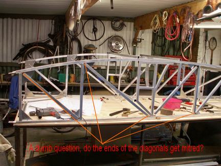

Another pic.
Completed the right hand side today, tomorrow we will flip the frame and clamp the left side to it so they match perfectley.
l will be using the new tail that the Sieria's are using, purley asthetics really.

And still it is too small. 12*7m
l have one car in storage at mums.
Keeping very mindful of what its where l had to scollop a piece out of the 2nd rear diagnial, so that if one of the elevator bolts wants to be there it can.
Orded some new claps before christmas, havent arrived yet so l'll be scrounging around the neihbors.

Both sides are ready to go together, bolted the frame in.
Using aircraft bolts for the first time required a little study, l am used to using them for tooling and equipment we had built, most of the time you over specified.
Using a bolt so that no shear forces went through the thread root, in the past l would have used more or much larger bolt.
Putting a number washers under the nut so that the grip range was correct is also something new, learning lots of new things which is always good. :biggrin:
l will be leaving the frame as is for a few days as l mull over things (admire my handywork)
Might fit a couple of gussets to the centre section and lay out the crossmembers.

Goodaye all
More progress today, the sides have been pulled in and 90% of the braces are fitted.
Ran a string line down the centre and its spot on without any tweaking. 037_yikes.gif.f44636559f7f2c4c52637b7ff2322907.gif :clap2:
Very pleased with the dimensions and keeping things tight will pay off with less problems later.

Finished putting braces and gusset's in the fuselauge frame today.
The center line is perfect and left to right is perfect as well, very pleased by that.
The chrome molly frame needed stress relieving at two points, managed to get it even.
Looks like a plane now.
Even without the skin the frame feels sturdy and l know why Gary's Aircraft are consided tough, simple and strong.
