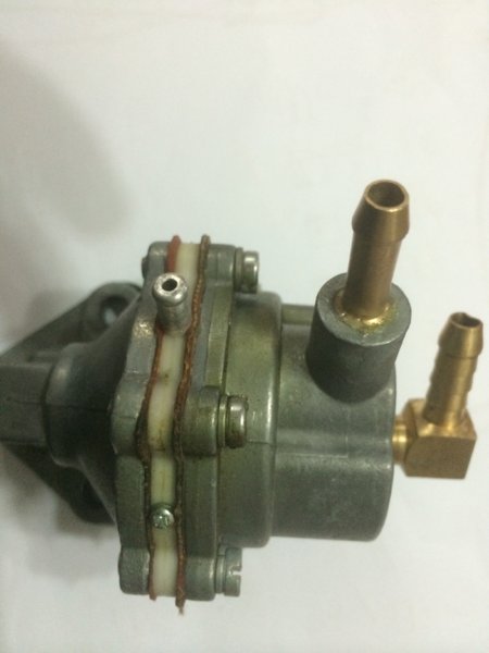

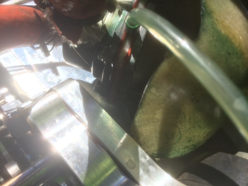

deadstick Posted September 2, 2014 Share Posted September 2, 2014 Had an issue last week with the mechanical fuel pump on my J230-D, had a fuel fume smell in the cockpit on the last flight, next morning I went to pull the cowls but as I approached the A/C I noticed the tarmac had been eaten away near the nose wheel. So I pulled the cowls and found the fuel pump was leaking between the diaphragms and that the retaining screws were loose. Interestingly the screws have no form of locking! they have now ( LT 620) as I think an inflight fire would have been inevitable if I was on a longer flight the day before. Engine and pump have done a total of 35.4 hours. Anyway just sharing for info as its definitely something to check. (Defect report submitted) 2 Link to comment Share on other sites More sharing options...
