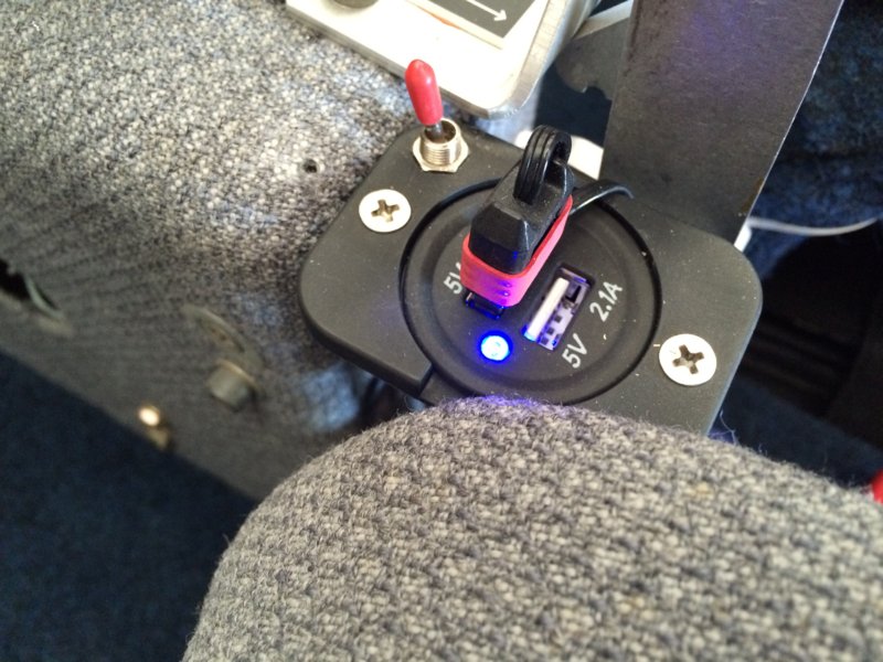

AVOCET Posted March 31, 2015 Share Posted March 31, 2015 Couldn't see a link Sorry about that , im in town mow so i can post with ease . Ive changed out the cigarette plug and fitted these USB plugs , google or ebay , 1 Link to comment Share on other sites More sharing options...

aj_richo Posted March 31, 2015 Share Posted March 31, 2015 Avocet, I tested one of those USB socket outlets in my panel, found it caused a lot of hash breakover on the radio whenever it was charging devices. Made the thing unusable if I wanted to maintain a listening watch. Haven't bothered tinkering with ferrites and such as yet Link to comment Share on other sites More sharing options...
AVOCET Posted April 1, 2015 Share Posted April 1, 2015 Ive had one flight with it fitted and only 2 radio calls , .Didnt notice anything unusual , "yet". Ive fitted one to run the blue tooth EQ1 for the i phone , and one to run the go pro like camera . Mike Link to comment Share on other sites More sharing options...

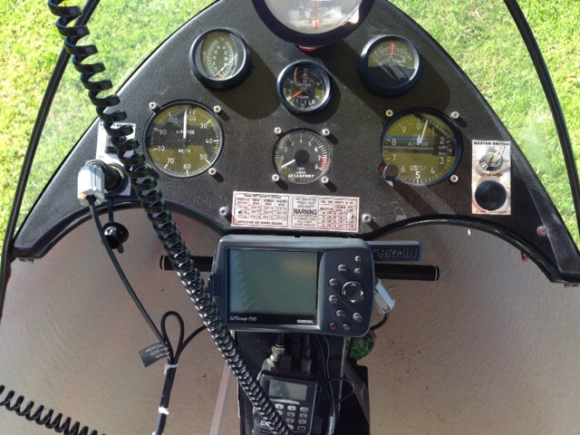

Mark11 Posted May 18, 2015 Author Share Posted May 18, 2015 Pic showing ferrite at both ends of GPS charge cable Link to comment Share on other sites More sharing options...
