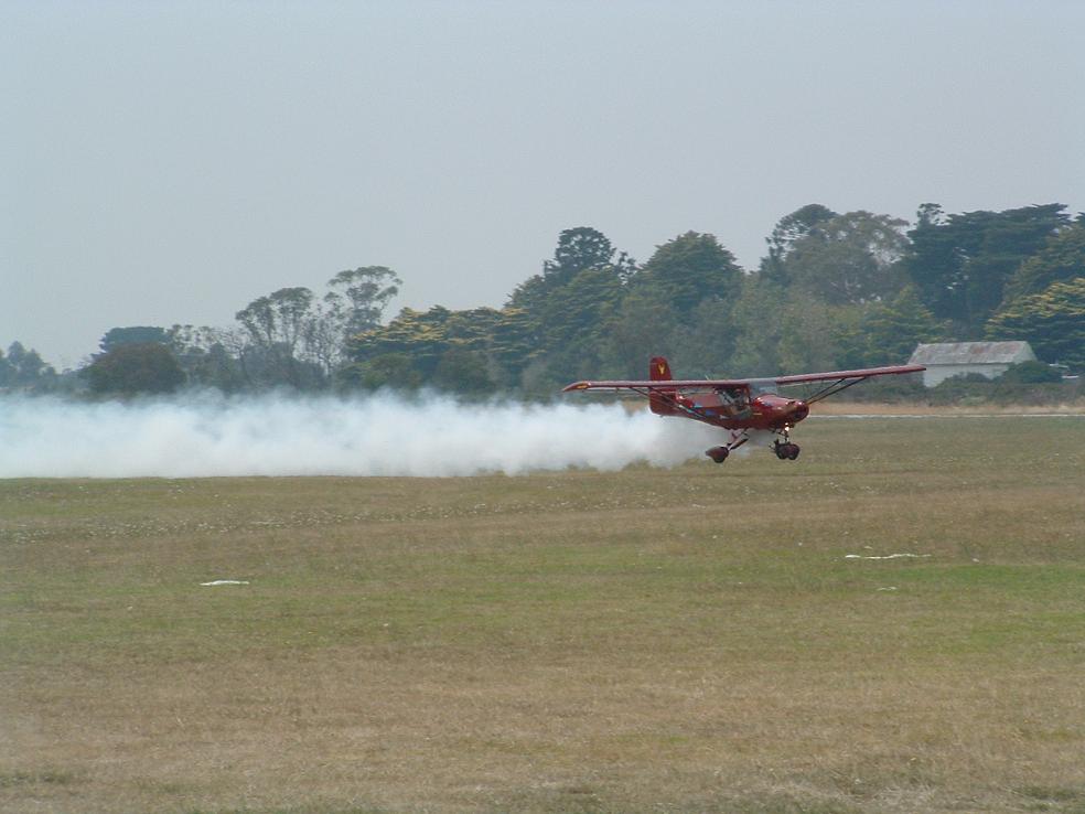

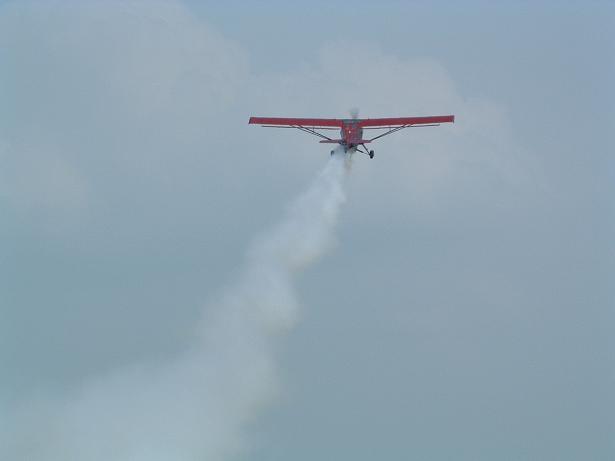

Student Pilot Posted May 28, 2006 Share Posted May 28, 2006 URGENT message for the guest post, if you know who owns the Gazelle in the picture tell him not to fly it anymore until he gets the engine checked out! Every picture posted has the Gazelle pouring smoke out, maybe he's overboosted the consosinator? Link to comment Share on other sites More sharing options...

Student Pilot Posted May 28, 2006 Share Posted May 28, 2006 At that extreme climb angle (3.5 degrees) for a Gazelle, that smoke must be coming from a JATO bottle. Must be close to gross with 2 folks, 15 litres of fuel and 15 litres of vegetable oil that's injected into the exhaust? Link to comment Share on other sites More sharing options...
pylon500 Posted May 28, 2006 Share Posted May 28, 2006 C'Mon Glen, you're not getting all cynical on us are you? I've been flying in a Gazelle with half fuel and a couple of 'average' blokes on board, and I thought 300 fpm was doing all right! I'ts not like it was 40C outside, I thought it was only about 37C!! Still there's some good thermols around everly. Arthur. Link to comment Share on other sites More sharing options...
