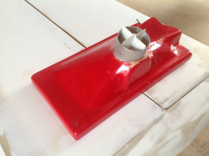

stuffed the camera down the airbox and through the cobra neck today to check the silicon had not migrated over any of the holes around the carb inlet and tilted the carb top to the rich side, all good, just hoping the weather clears up for some test flights tomorrow. also switched to BP ultimate 98 ron fuel as supposed to clear carbon out of the cylinder according to the web site, will take a few hundered ltrs to clean mine up Lol

I did a 100 hr service today on my jab, I can now confirm after about 4 hrs since fitting the cobra head my plug colours are all matching, so it worked. cylinders 2 and 4 are richer, 1 and 3 are leaner, all plugs the same colour, will post pics as a comparrison. only thing I found that I was not sure about was no 2 head after taking off the valve cover the oil residue in the cover was brownish, could be condensation build up as the jab has not been ran for 3 weeks (in the UK)the ali around the valve spring on the head showed a light brown staining, so poss blow back from the valve guide, all the other heads were fine. now to do a leakdown tomorrow

fuel is 8 to 10 ltrs per hr. #2 #4 are lean as plugs white, the other two are black rich, its not jetting its the distribution through the plenum box I think, more is going to 1 side than the other. i have searched the net and I think a cobra head with the cross in it or a plate baffle should improve the distribution to these pots going by others and various things I have read, this is my next move. any one had experience using these?

You can tilt the carb slightly to one side or the other to even out your mixtures left to right. Can't remember which way riches but a search here should find the relevant info.
