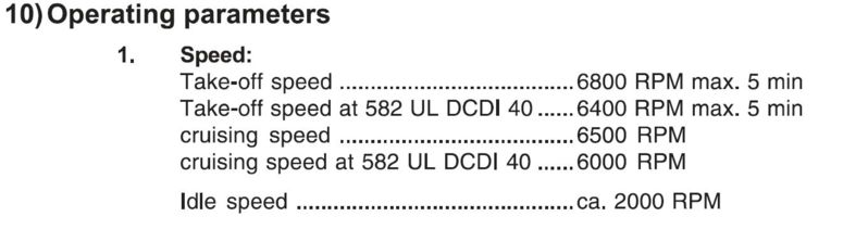

flyerme Posted February 11, 2013 Share Posted February 11, 2013 There is a lot of threads on topic of what the maximum rpm should be on a Rotax 2 stroke so I decided to find out the truth behind all the beliefs.I first checked the rotax manual,then rang Wal at bert flood ,then a few other dealers (qld and uk) eventually I was able to email bombardier Rotax HQ Austria. was interesting on what they specified. All Rotax 2 strokes share the same RPM .MAX 6800 rpm REDLINE REDLINE REDLINE BEFORE ENGINE DESINTIGRATION. Max Rpm should NOT exceed 6500 rpm. running no more than 5 mins max(IN STREIGHT AND LEVEL FLIGHT ONLY) static full power should be around 6000 -6200 rpm max take off climb should be 6200-6400 rpm max and streight and level flight at full power should be 6500 Rpm 5 mins MAX maximum rpm refers to full power in streight and level flight NOT TAKE OFF CLIMB!! I however climb out at 6500 rpm but I may be rethinking this now. 1 1 1 Link to comment Share on other sites More sharing options...

horsefeathers Posted February 11, 2013 Share Posted February 11, 2013 Here is a cut and paste directly from the Rotax Owners manual for the 447, 503, and 582 - it seems the only difference in engine speed is with the older 40 Kw 582. But, in a nutshell, 6800 rpm max for 5 minutes, 6500 rpm cruise speed Link to comment Share on other sites More sharing options...

horsefeathers Posted February 11, 2013 Share Posted February 11, 2013 uhhh, dont mean to be ULTRA picky, but a 582 doesn't have any Oil Pressure..... That looks like a page from a four stroke engine manual, perhaps a 912 Link to comment Share on other sites More sharing options...
Patrick Normoyle Posted February 11, 2013 Share Posted February 11, 2013 Might be the oil injection ? 1 Link to comment Share on other sites More sharing options...
horsefeathers Posted February 11, 2013 Share Posted February 11, 2013 Might be the oil injection ? Oil injection on the 582 is gravity fed, and the temp of the injection oil is not monitored. Link to comment Share on other sites More sharing options...
flyerme Posted February 11, 2013 Author Share Posted February 11, 2013 uhhh, dont mean to be ULTRA picky, but a 582 doesn't have any Oil Pressure..... That looks like a page from a four stroke engine manual, perhaps a 912 I asked about that and is mentioned in another thread ,apperently it refers to the oil injection pressure for lubing the water pump/or for the 2 stroke oil injection? I forget now but minor details?its definatly a rotax 582 blue top manual.there was other descepencies in the manual I had cleared up from rotax. My good friend has an older 582 and his manual is practicly identical?wonder if they just mass produce and change a few minor details? pretty crap when Rotax themselves state one thing and their manuals another? speaking to Wal at Bert flood he recomended what the manual states (6500 max 5 mins on take off) he also mentioned (where i became lost) torque range/line? at certain revs ,power band ,etc..I cruise at 5200 revs .seems good on fuel and cruises nice at 65 knts. but I may not be running at optimum performance,5400-5800 revs cruise setting? So as you can see theirs a lot of different info out there,I have sent a message yet again to Rotax Austraia inquiring on why they messaged one thing whilst there manual states another? I have given them engine and model numbers gear box and ratio.now to wait for a reply. Link to comment Share on other sites More sharing options...
horsefeathers Posted February 11, 2013 Share Posted February 11, 2013 Sorry, just dont buy it. My 582 manual has NO mention of oil pressure, and the latest manual you can download doesn't mention it. Can you post the front cover of this manual (make sure the part number is clearly visible) to clear up any inconsistency? Link to comment Share on other sites More sharing options...
horsefeathers Posted February 11, 2013 Share Posted February 11, 2013 [ATTACH=full]20699[/ATTACH] from my rotax 582 blue top manual..different ? hence the need to contact an authority.. Ahhh, just noticed, that picture I believe is from a specific aircraft manual - Rotax engine manuals dont specify tyre pressures. So, I would NOT take the advice in that as gospel. Thats not to say that the particular aircraft should not use those engine speeds, but read the actual Rotax manual for factory engine specs. 1 Link to comment Share on other sites More sharing options...

flyerme Posted February 11, 2013 Author Share Posted February 11, 2013 Im well aware of what the latest manual states as I was ripped off buying it on cd when you get it for free off the net.idjet i am sometimes.. I have posted a pic of my Aircraft manual LW gr 582 blue top section " engine 582 blue top power plant limatations" to show the difference.This is why I became confused after purchacing the latest manual.? I have spoken with a number of rotax dealers and get different OPINIONS ? received an email this morning from a bombardier rotax with the info posted.Hence a great need for discussion as I dont want to be over or under propped?I have gone with 6500 rpm on take off and drop to 6000 after 3-4 mins but still cruise at 5200 (save fuel) but would hate to think im doing harm? ISo im up for all good input because I want my engine set right. Edit - should mention with old fixed prop was only getting 5900rpm on take off. been like that for 400+ hrs before I came along Link to comment Share on other sites More sharing options...

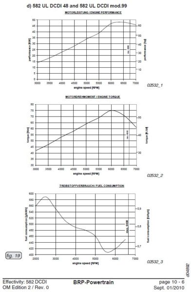

horsefeathers Posted February 11, 2013 Share Posted February 11, 2013 Skyfox1 numbers match the manual, but you are not going to do any damage limiting your Max revs to 6500, so the numbers you fly sound OK as well. If you look at the Rotax engine performance chart,you'll get an idea of the best rpm vs fuel consumption,but of course,this may vary due to your airframe. But its a good starting point to get the most out of your fuel tank 1 Link to comment Share on other sites More sharing options...
flyerme Posted February 11, 2013 Author Share Posted February 11, 2013 Skyfox1 numbers match the manual, but you are not going to do any damage limiting your Max revs to 6500, so the numbers you fly sound OK as well.If you look at the Rotax engine performance chart,you'll get an idea of the best rpm vs fuel consumption,but of course,this may vary due to your airframe. But its a good starting point to get the most out of your fuel tank cool thanks but what about my cruise setting? from what Im finding is I should be up sround 5800rpm for cruise but would this use more fuel? I like cruising around at 5200 rpm,65 knys only uses 12 ltrs an hour and feels smoother at that setting? but was told im not in the powerband range? does that really matter? side note =reason for thread I just fitted a new bolly 2 blade ground adjustable and want it set up right.thankyou:smile: Link to comment Share on other sites More sharing options...

horsefeathers Posted February 11, 2013 Share Posted February 11, 2013 does prop and aircraft matter?gsc props recommend no more than 6200rpm on take off with there props on a blue top 582 ? You need to obviously take the prop manufacturers recommendation into account here - you dont want it self destructing just because your engine CAN spin it faster. As to takeoff revs - take a quick look at the page below from the rotax manual for the 582 (Fig 1 and 2) Max torque is approx 6000 - 6100, max power 6200-6300, so that's probably (once again purely from the engine perspective), the best climb speed for your engine. Going faster will not give you any extra power OR torque. You lose 10% torque by increasing revs from 6100 to to 6800. So why go to 6800 RPM on takeoff??? I can't answer that - anyone else care to offer a why on this? Re cruise speed Vs fuel consumption (fig 2 and 3) 6000 RPM seems like the sweet spot, as it gives almost minimum fuel consumption, max torque, and almost max power. Cruise at 5300 RPM, and you'll use the same fuel, but generate less power. Once again, these are pure engine figures. By cruising at 6000 RPM, you may suffer increased drag, thus slowing your aircraft down. Its a 'suck it and see' exercise for you aircraft and prop combo. But at least you can see where the engine itself performs best. 1 Link to comment Share on other sites More sharing options...

Guest wildman5354 Posted August 10, 2017 Share Posted August 10, 2017 1st, the Power Graph/Chart for engines is at FULL THROTTLE at ALL RPMs. you get a power curve for your engine, go to a specific rpm, find the hp for that rpm on the curve, that is the hp AT FULL THROTTLE!!! same for the TORQUE and FUEL CONSUMPTION!!! if you want to know these values at REDUCED THROTTLE OPENINGS you need to know RPM, MANIFOLD PRESSURE and AMBIENT AIR TEMPERATURE and a PERFORMANCE CHART from the engine manufacturer. if you set the prop pitch to hold the rpm to 6200 @ FULL THROTTLE then you look on the power chart that hp IS correct. if you then throttle back to 5800 rpm and look at the chart you ARE NOT making that hp indicated for that rpm. again, the Power Graph/Chart for engines is at FULL THROTTLE at ALL RPMs. 2nd, the statement "Correct me if I'm wrong, and it's been a while since I've done any serious physics calculations, but:- a fixed pitch prop will always generate more thrust when it's spinning at 6800 RPM than at 6200 RPM" is generally true (for a fixed pitch prop) as long as the tip speed is below the speed of sound. as the tip speed approaches mach .9+ thrust will drop significantly. 3rd, all rotax 2-stroke engines are DE-TUNED derivatives of snowmobile engines. the 582 for example is a 583 detuned from ~100hp to ~65hp. this has 2 effects - much, much more longevity and much better fuel efficiency. but, they are still built for the stresses the snowmobile engines are designed to operate with. the 583 revs to 8000rpm+ and does not "MAX 6800 rpm REDLINE REDLINE REDLINE BEFORE ENGINE DESINTIGRATION" as mentioned above. the limits on the "AIRCRAFT" engines are for longevity reasons. 2-stroke engine life decreases exponentially as power/rpm are increased, everything else being the same. so if you propped your 582 to rev to 6800rpm at full throttle level flight and flew at full throttle for cruise the engine wouldn't last as long as if you propped it to 6500rpm full throttle level flight and flew at full throttle for cruise. Link to comment Share on other sites More sharing options...
