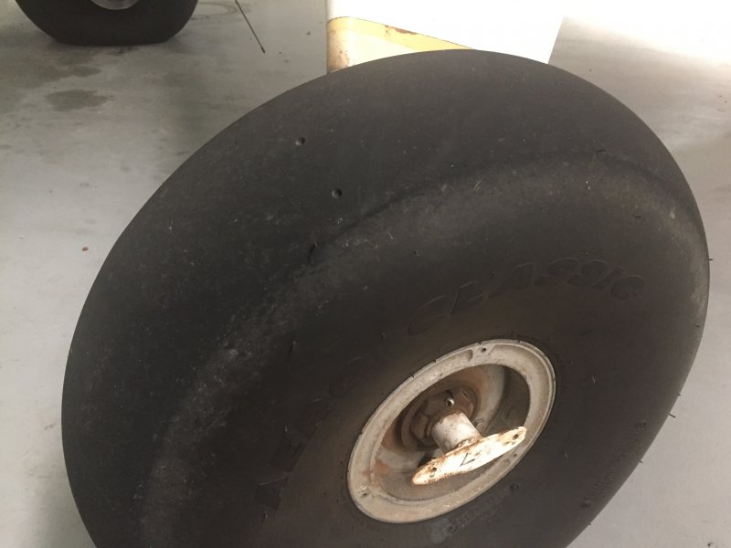

vk3awa Posted February 25, 2016 Share Posted February 25, 2016 Hi, Just fitted a new set of main wheel tyres on my Jabiru 120. The tyres were supplied by Jabiru and are Trelleborg brand 4.00 x 4 6ply. Unfortunately, due to the profile of the tyres, they foul on the brake caliper bolts. It appears that suppliers, including Jabiru, are having trouble supplying ribbed tyres. Looking for ideas as to where I can source suitable tyres. THANKS Daryl Link to comment Share on other sites More sharing options...

Mackagri Posted February 28, 2016 Share Posted February 28, 2016 yes Trelliberg tyres are great. Just take the caliper bolts out & turn heads of bolts towards tyre. done 50 hrs ago. 1 1 Link to comment Share on other sites More sharing options...

vk3awa Posted March 1, 2016 Author Share Posted March 1, 2016 Mackgrl, I'm not sure how turning the caliper bolt around would help. Still have to fit a nut which would also foul on the tyre. How did you overcome? Cheers Daryl Link to comment Share on other sites More sharing options...
Mackagri Posted March 1, 2016 Share Posted March 1, 2016 The head is narrower than the nut , so if the head faces the tyre & nut faces centre of the a/c it will just clear the tyre. I asked Jabiru service if this was ok & said it was correct.( put washer under nut not the bolt.) We are getting much more life out of the Trellibergs . Cheers Dave. Link to comment Share on other sites More sharing options...
vk3awa Posted March 3, 2016 Author Share Posted March 3, 2016 THANKS Dave, Tried that. No good. Bolt head still rubs on tyre wall. Cheers Daryl Link to comment Share on other sites More sharing options...
facthunter Posted March 3, 2016 Share Posted March 3, 2016 The bolt head without a washer is much thinner than a nut and washer You might deepen the spot facing on the caliper IF it doesn't weaken it. You can round the edges of the nut as well provided there is enough hex to hold it when tightening the nut. Nev Link to comment Share on other sites More sharing options...
peterm Posted March 3, 2016 Share Posted March 3, 2016 Ju The bolt head without a washer is much thinner than a nut and washer You might deepen the spot facing on the caliper IF it doesn't weaken it. You can round the edges of the nut as well provided there is enough hex to hold it when tightening the nut. Nev just flock the bolt head in then you have 1 spanner adjustments. Link to comment Share on other sites More sharing options...
Mackagri Posted March 3, 2016 Share Posted March 3, 2016 Daryl, my bolts just clear the tyre. I agree with Nev, Just deepen the caliper by 1mm. Dave Link to comment Share on other sites More sharing options...
