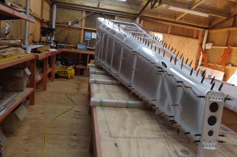

IBob Posted January 13, 2017 Posted January 13, 2017 Mmmmmmmmmmmmmmm! And the clamp/s on the table edge are to prevent it falling off if we have more earthquake excitement: gotta get your life priorities right!!!

MajorTom Posted January 14, 2017 Posted January 14, 2017 @IBob that looks realy nice! what is the size of your workbench? I was thinking to built mine 4,00 m x 1,00 m x 0,75 m ... what do you think? Thanks for the hint to try Transferwise. Any idea what the shipping cost of 500 clecos might be?
IBob Posted January 14, 2017 Posted January 14, 2017 Quote @IBob that looks realy nice! what is the size of your workbench? I was thinking to built mine 4,00 m x 1,00 m x 0,75 m ... what do you think? Thanks for the hint to try Transferwise. Any idea what the shipping cost of 500 clecos might be? Thanks, MajorTom. My original bench was 4.8 x 1.2 x 0.9 high, being 2 sheets of ply: longer than it needed to be, but I had the room, and a bit of height is easy on the back for deburring and building the flat bits. At that length it had an unused end, which was nevertheless handy for parking manuals, tools, small deburring etc. Then I was told I would have to lower it to reach the high bits on the fuselage. So while doing that I also shortened it so I can hang the front fuse off the end, and narrowed it a bit, so I wasn't reaching so wide across. But this was done with the next owner in mind, as the table is going on to another Savannah build, so I measured a wing and made sure it was still big enough for that. It is now 4.0 x 1.1 x 0.75, and I would say an adequate size at that. And it happens that the box the kit comes in is 4.3 x 1.1 x 0.75, so building on the box top (as many have already done) would be fine. Shipping for my clekos was US$82 from US to New Zealand. They are quite heavy. On receipt there was also some duty etc. I need to point out that I am a novice, on my first build, and there are people on this site with far more knowledge than I. The cleko quantities I gave are just a generous average from the various advice I received. And, while I have been happy that I had that number, I expect there are builds that use less. The major difference from early builds would be the S fuselage, where you are clekoing all 4 curved 'corner' skins the full length of the fuselage: by the time I had all skins in place, I was using almost every Copper cleko I had. It is also nice to have plenty when doing the wings. 1
eightyknots Posted January 14, 2017 Posted January 14, 2017 Quote 0.36$US looks like a good price to me.Once you work through the business of importing your own parts, it shouldn't be difficult, and it's well worth it. Suggest you look into Transferwise, or something similar to avoid getting ripped off with exchange rates and transaction fees. It takes a little bit of setting up, but is very cost effective, and the money arrives overnight. Plenty of builds have been done with fewer clekos than quoted, but the more you have, the more neatly and firmly the assemblies are held together. Also the S takes more, especially in the rear fuse. Yes, it's a cost, but I took the view that I didn't want to be fighting the thing...and as a first time builder, I need all the help I can get! S rear fuselage with 400+ clekos in it. You're going to love it!!![ATTACH=full]47717[/ATTACH] That fuselage is positively bristling with clekos!
IBob Posted January 14, 2017 Posted January 14, 2017 Quote That fuselage is positively bristling with clekos! It's every 3rd hole, at best, Hank. Sometimes every 4th. And you're pulling the curve into those corner skins.

eightyknots Posted January 14, 2017 Posted January 14, 2017 Quote .... It is now 4.0 x 1.1 x 0.75, and I would say an adequate size at that. And it happens that the box the kit comes in is 4.3 x 1.1 x 0.75, so building on the box top (as many have already done) would be fine. Shipping for my clekos was US$82 from US to New Zealand. They are quite heavy. On receipt there was also some duty etc. .... Bob, Have you ever used NZ Post's "Youshop"? I have used this several times for two kinds of shipments from the United States: (a) traders who won't send any items beyond "contiguous United States" or "North America"; and, (b) where the shipping costs are exorbitant. If you register with Youshop, NZ Post issues you with a unique US postal address. You then pay the trader for US postage (which is relatively cheap most of the time) and then NZ Post-cum-Youshop does the rest at a reasonable price. See: YouShop | New Zealand Post YouShop pricing | New Zealand Post

MajorTom Posted January 14, 2017 Posted January 14, 2017 Quote It is now 4.0 x 1.1 x 0.75, and I would say an adequate size at that.And it happens that the box the kit comes in is 4.3 x 1.1 x 0.75, so building on the box top (as many have already done) would be fine. Sounds like a real good idea. Just wondering if the surface is plan enough ( esp. twistfree ) Had some luck and discovered some steel parts that will make a good base structure for my bench. Intend to put film coated plywood on top, to which a have easy access. Guess it would also be good to have some drawers under the table 1

IBob Posted January 14, 2017 Posted January 14, 2017 The Savannah does not need a precise flat surface for the build, and the box lid, with some simple reinforcement, would be more than adequate. I just thought it would be easier if I started with a big flat surface. And I'm all for easy! I am also spray priming as I go: the box has been good for laying out the skins for that, while the table is used for deburring and assembly. There's a heckuva lot in the box, and I made shelves (more ply) so I could spread out a lot of the smaller stuff. I also put in a single low shelf under my table. It can be pretty difficult for the novice to find the bits he is looking for, and spreading the parts out like this helps. I have also read of folk who cut across the centre of the lid, which gives them two sliding halves for access. Could work well if you are stuck for space?

IBob Posted January 14, 2017 Posted January 14, 2017 Quote Agreed! I like the way you have primed the rivet lines, and white is a good choice for internal areas too.As for clekos I have asked for a shipping cost from Browns so will let you know what they say, you can instantly add 20% vat though :( I will hold fire on the order until I have done the first assembly as I have plenty of time and am in no rush... other than to get started! I am now worrying about the transport as it has decided to snow here and that can last several weeks making a trip to Italy rather hazardous. As Marty D said above, you will get a hundred different opinions on anti-corrosion/paint, some of them very fiercely held! I made my own decision on this, but it is only a 'best guess', and I hope will prove adequate. In my case, I am not going for a concours finish, neither am I trying to build an aircraft to last 50 yrs. I am also wanting to get into the air without too much delay, so my choice of paints etc is a deliberate compromise round all that. 1
IBob Posted January 14, 2017 Posted January 14, 2017 Quote at the factory they haver relatively short low benches with a plain plywood top and steel frame. the dealer explained that it doesn't really matter too much about flatness as the frames are self jigging and when all those clekos are in place the structure is square and rigid. I guess it would be a good idea to check all the same. I was going to get some of that felt protective cloth they use on floors to prevent scuffing and scratches to the aluminium. Most of my assembly has been done with the part resting on 50 x 50 battens wrapped in bubble wrap. This is to give clearance for the clekos sticking out the bottom. You can see them under the fuselage pics I posted.
