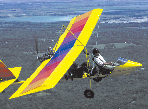

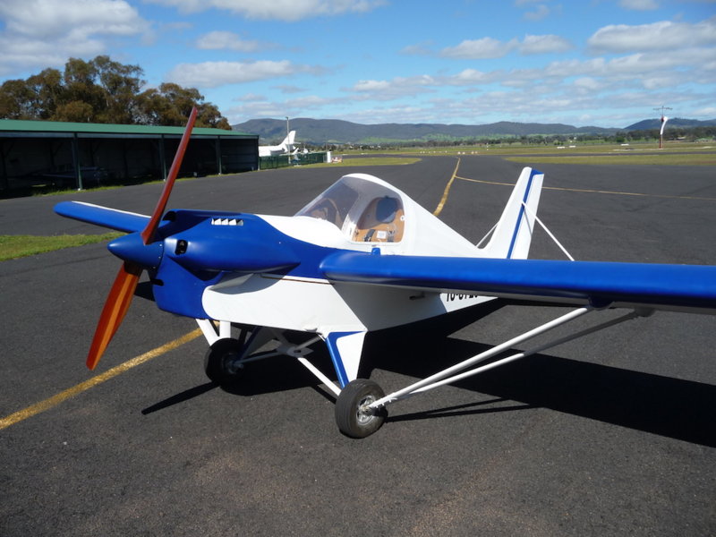

Soleair Posted January 30, 2017 Author Share Posted January 30, 2017 I'm not really sure what your point is in that post, Nev. But as regards seizing up, my EGT's were respectively not above 1050 & 1000 deg F, & my CHT's never went over 350 deg F. My plugs are all light cocoa coloured. So I don't think I'm in any danger of imminent seizure. Your other statement is to the effect that a Drifter with a 582 returns 13 litres per hour. Well, that was why I posted my test results: to show that not all 95.10 aircraft powered by 2 stroke engines are necessarily thirsty. The 582 anecdotally does not produce as much power as the MZ engine, so would need to be operated at higher throttle openings, implying greater fuel burn. As to the aerodynamic qualities of the Drifter versus my MiniMax, I invite you to compare the 2 photos attached. Your comments on cross country fuel planning hold good for any combination of airframe and engine, so they not particularly relevant to 2 stroke fuel consumption. Link to comment Share on other sites More sharing options...
