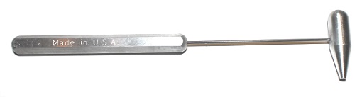

M61A1 Posted December 30, 2017 Posted December 30, 2017 I agree that there's not much to service. As far as manufacturer inspections, it's a means of ensuring that their product meets their standards. Possibly they have ultrasonic test equipment, that said, when I tried ultrasonic on a Ward Drive prop, it was useless because of the curvature around the blade root, which was the bit I was concerned about. You can make a tap hammer out of aluminium or brass (depending on which works better) pictured below. If the crazing is in the resin matrix, it can be sanded, as long as structural fibres are not damaged, and resin wiped to restore the finish. But I would only be paint that has crazed. You won't know until you sand it off. G ood quality epoxy resins must be used, none of that polyester rubbish.
skippydiesel Posted December 31, 2017 Author Posted December 31, 2017 Quote I agree that there's not much to service. As far as manufacturer inspections, it's a means of ensuring that their product meets their standards. Possibly they have ultrasonic test equipment, that said, when I tried ultrasonic on a Ward Drive prop, it was useless because of the curvature around the blade root, which was the bit I was concerned about.You can make a tap hammer out of aluminium or brass (depending on which works better) pictured below. If the crazing is in the resin matrix, it can be sanded, as long as structural fibres are not damaged, and resin wiped to restore the finish. But I would only be paint that has crazed. You won't know until you sand it off. G ood quality epoxy resins must be used, none of that polyester rubbish. [ATTACH=full]53268[/ATTACH] Very cute hammer - I think large coin will do me for now.

M61A1 Posted December 31, 2017 Posted December 31, 2017 Quote Very cute hammer - I think large coin will do me for now. A coin works well on flat (horizontal) surfaces. The idea is that you hold the coin about 1/2 inch or so off the surface and let it bounce, hard to do on a vertical surface. I prefer tap hammers.
