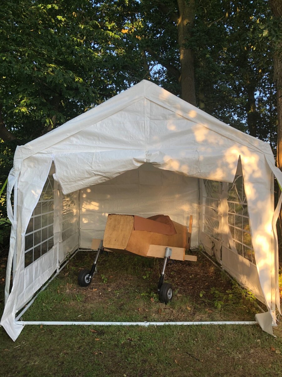

Teggles Posted July 23 Posted July 23 With spars and undercarriage, it doesn’t fit back in the workshop! Quick plan, erect a tent in the woods and see how it goes! Next major job is fitting the spars, making sure I get the correct angle of incidence. Trial fits so far show the slightest change makes a big change to the angle. No absolutely sure how I can get a consistent angle, take it apart, apply glue and get it back together again with the correct angle. 2 1

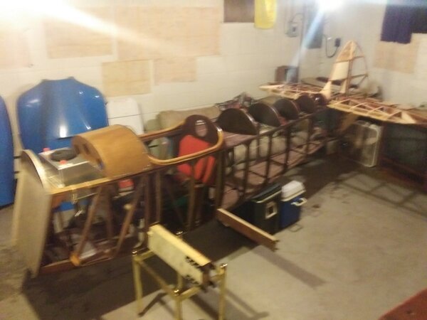

RYoung Posted July 25 Posted July 25 I must admit that your worry is one of my future “worries”. I haven’t started assembling my wing panels yet. All the basic bits are built. My basic plan was to bring the complete wing panels up to the fuselage with it on my bench. Then with the aid of a spirit level, lazer level and digital protractor line up the rear spar in the fuselage to make it work and then glue the rear spar to the fuselage. I built my Sonex this way, I still took 2 days to “only” drill 4 holes however. I’m still a bit away from making vroom, vroom noises yet. Regards Richard. 1 2
Don J Posted July 31 Posted July 31 Teggles. Looks nice and good to see widows on the tent🙂The quicker you can get the Fus covered with fabric and sealed the better off it will be. Condensation could be a real bite in the backside sitting outside. I have been working on power plant and the new 42 hp inverted V twin that the Spirit SE-1 new at Oshkosh this year sure looks like a good way to go. I have a 1835 VW but weight is a deal breaker on that route. Hope everyone is well and flying in smooth air across the pond. DJ 2

Teggles Posted August 1 Posted August 1 The fuselage has been varnished on the inside and Stewart’s sealant on the outside. I am covering with the Stewart system as I hope to do that this winter in my house. Next big job is to permanently fit the spars and get the angle of incidence right.

Teggles Posted August 1 Posted August 1 This will all be accomplished in the tent in the woods. I will drill the wing attachment fittings in the spar when the spars are out of the aeroplane to ensure they are drilled square. The 3 degrees angle of incidence - I can use the measurements on the drawing, I just might need so wood shims. 1
