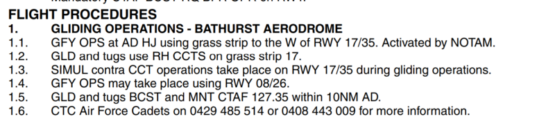

Current YBTH notam (below) indicates the RAAF cadets have a gliding camp in progress. Power traffic circuits for Rwy 17/ 35 at YBTH are now permanently to the East (ie RH circuits on Rwy 35, LH on 17). Can someone explain what is meant by " ... RWY 17/35 NON-INDEPENDENT CONTRA CCTS. PARL RWY OPS NOT PERMITTED" Thanks, Bill

There is a full stop in the middle so two separate sentences.
RWY 17/35 NON-INDEPENDENT CONTRA CCTS. = There will be gliders doing circuits to the opposite side of the airstrip, that means that aircraft may be head to head on base/turning final to line up on the same runway so keep a very good lookout, especially for aircraft already on final!!!!
PARL RWY OPS NOT PERMITTED = parallel runway operation not permitted ie 2 aircraft landing side by side, as might be common at a gliding location like Narromine where the grass runways are very wide.
There is a phone number at the end of the NOTAM, I am sure they would appreciate a call in advance if you have any queries. Easier to sort out before hand while still on the ground.
Thanks for the explanation. The word "NON-INDEPENDENT" is what caused the confusion (for me & 2 others). Replacing it with SIMUL (simultaneous) would have been preferable. And btw, we rang the number given (no answer), left a voice mail msg requesting a call back & 4 days later - still no response.
