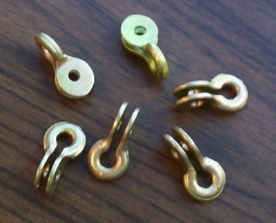

Secondly - cable shackles (see pic below)
These handy little things seem ideal for the control surfaces and elevator bellcrank (so 6 required).  Trouble is they seem to cost an arm and a leg.  Aircraft Spruce in US sell them for $10.85 each,  I logged on to an Australian supplier (AAE) who have them as something like $38 each.
So it looks like an Aircraft Spruce order (when the dollar gets higher perhaps...) unless anyone knows of a supplier here or has some spares they'd like to sell??

1/8 SS cable in 7 x 19 is fine used with nicopress swages and thimbles with the drilled plates as used by Zenith and Savannah. If you can make them to length, small adjustments can be made with the nosewheel steering rods.

If you want cables assembled in Australia that is good. I think we should support local, BUT when I replaced my cables I got quotes from a couple of Aussie suppliers. From memory they were x much per cable, plus x much per fitting plus a big number of dollars for the paperwork. I bought from Aircraft Spruce at about 20% of the Aussie price. The order was taken and delivered in about a week with delivery to the door.
Much as I would like to support Aussie businesses I cannot afford to provide their pension. Probably not their fault, no doubt CASA has a big say.
