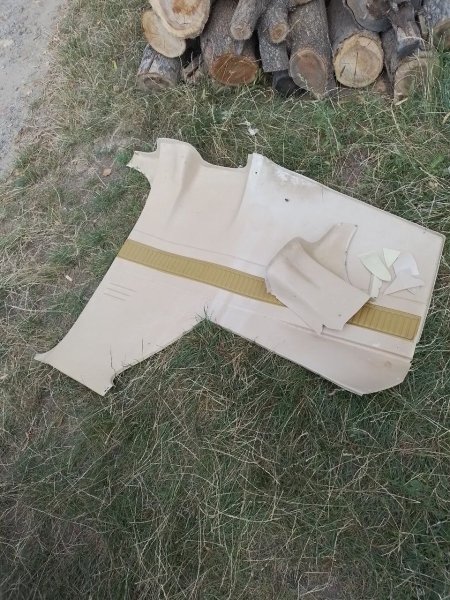

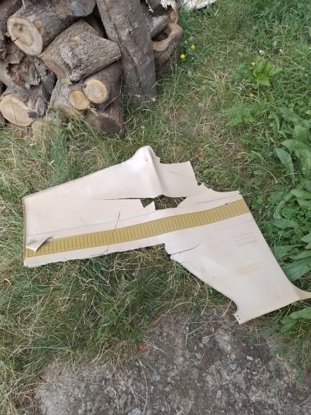

meglin Posted November 20 Share Posted November 20 Here would like to hear about the problems with plastic parts of Cessna airplanes. For some reason, what we get in our hands is all cracked, heavy, literally falls apart in our hands. Recently such rear interior panels were sent to me from Austria. They arrived in a huge box. One panel was already broken in half, and there were many splinters inside. In a gentle attempt to lift it, it broke in two again. The whole thing was covered with numerous cracks. Nevertheless, our experts managed to scan this horror. We have milled the dies and can produce these panels from a strong and lightweight fiberglass epoxy that is unafraid of age, ultraviolet radiation and does not support combustion. We now have another piece of this well-deserved airplane in our collection. The photo is of the parts sent in. There is a whole pile of wreckage nearby. Don't be surprised by the wood, I am heating the stove to save gas. We're already snowed in. Link to comment Share on other sites More sharing options...

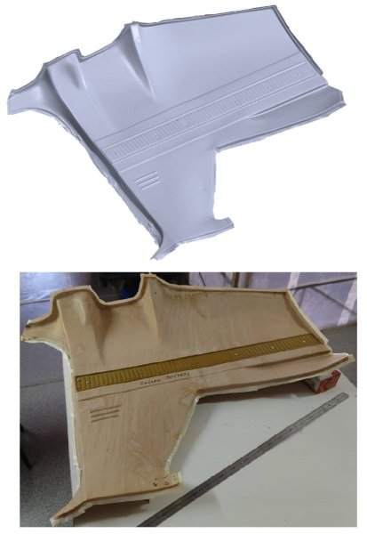

meglin Posted November 20 Author Share Posted November 20 The matrix for making this panel is shown below. Now you can make as many light and strong panels as you want for the Cessna C-150/152. Of course, it is more difficult and longer than ABS or polyester resin. But the advantages of heated epoxy plastic in terms of life, strength and weight are undeniable. You can even make it out of carbon fiber if you want. 4 1 Link to comment Share on other sites More sharing options...

meglin Posted November 21 Author Share Posted November 21 Of course you can. Even papier-mâché. But we want to ensure maximum strength and service life equal to the service life of the entire airplane. At a reasonable price. 4 Link to comment Share on other sites More sharing options...
