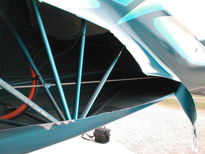

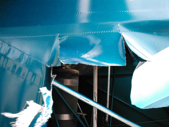

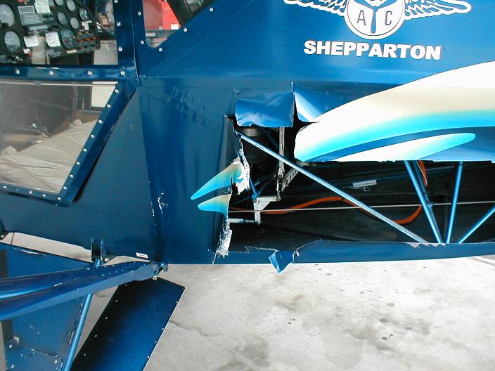

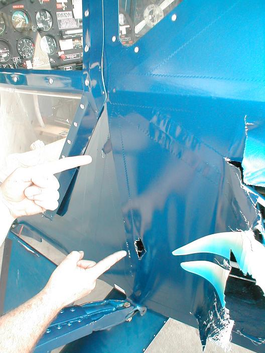

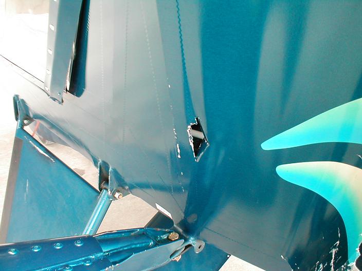

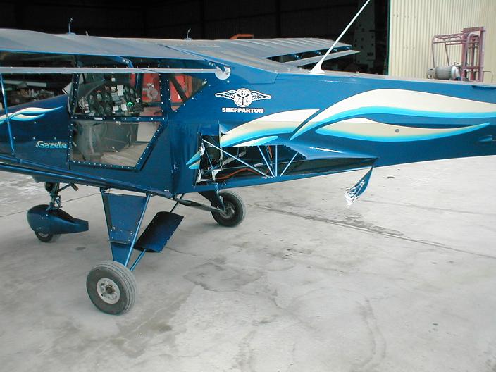

Guys, this is the result of NOT doing you preflight checks properly and in this case of my Gazelle the preflight check of Hatches and Harness secure - the pilot a) did not have his seatbelts on properly and the one he didn't put on he left hanging outside the aircraft AFTER he hade closed the door..
Remember they are there for YOUR safety (and the aircraft owners insurance agency).
The Gazelle can always be fixed but the pilot was lucky that more damage wasn't done to affect the handling characteristics or more importantly the elevator and rudder.
