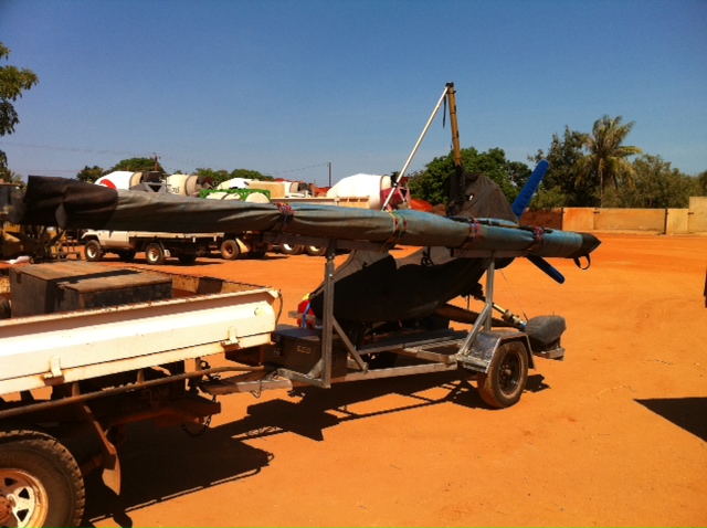

Aaron, how much does your trailer weigh? Did you design that from scratch or was it converted from some other use? Also, what are the things attached to the sides of the ramp? Are they springs of some description? How do you get the wing up the top?

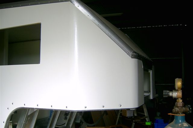

I've been in touch with the local Monopan distributor. He seems eager to be helpful and has supplied me with dimensions and weights. Two big advantages I see with this stuff are a)Weight/durability. The stuff is made from plastic and from accounts I've read elsewhere it's TOUGH. b)Sheet sizes. I was thinking of cladding my trailer with sheet aluminium. The 2400 X 1200 sheet sizes demand joints in sometimes awkward places. Not so with the Monopan. The sheet sizes are such that semi-trailer sides can be fabricated from a single sheet, they're enormous.
I've been invited to the showroom/warehouse by the local distributor who has also kindly offered samples. They'll most likely be offcuts but still useful to get a feel for the material.
Ray, thanks again for the tip. This stuff has already taken my trailer design to a whole new level.:thumb_up:

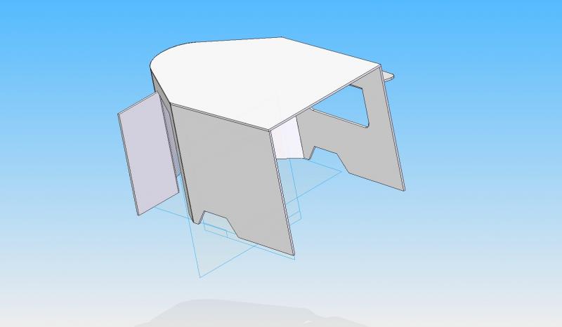

Here's some others that the Monopan people sent me.
The graphic is what I'm now considering. The walls will be made from one continuous piece of Monopan, the top from another piece. I think this can be made with no internal framework except for around the ramp door in the rear. Of course it will have to have a chassis...

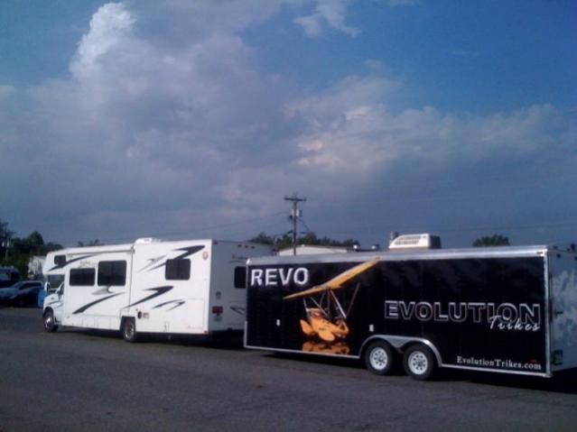

Scott, I've got my new Revo the second in Australia just arrived in Melbourne and will get to take delivery at the end of the month from LaTrobe Valley Airfield as I'm overseas next week. A project very dear to my heart is to design and have built an enclosed trailer that will take my Revo with wing attached but folded (its a strutted wing no King Post) and dropped onto a dolly to reduce height. The goal is to have rapid assembly and takedown without the physical labour of having to take the wing off and de-rig. The trailer will need to be about 20-22 feet long plus a 3 ft V nose, 6ft 6in high interior and width as close to the 2.5 metre max allowed for at least 2 metre internal width. The mobile hangar/trailer will be towed behind a motorhome to add another dimension to a trip around Australia. Design aim is to incorporate a 120 litre fuel tank, space for small motorcycle, airbag suspension, custom designed wing supports. Initial research shows Australia manufacturing prices in aluminium are $30k plus. USA build option around $12k including freight to Australia as option of including new Revo inside reduces freight costs. I'm interested in Monopan, can you advise distributor and person to get some advice re this material please? Cheers Herman

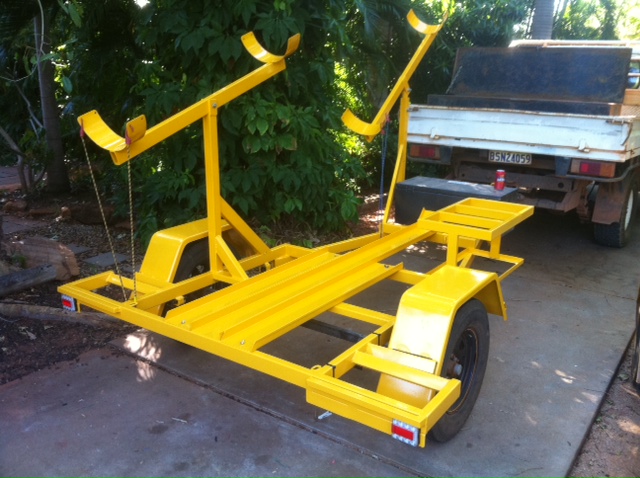

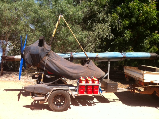

Hi All been following this thread and finally have finished my trike trailer. It has travelled 3000 km for the trial run and now has been powder-coated1056825193_photo3.JPG.79e4b0dcaf42d26c8253a57c38789d56.JPG
the design is such that I can load and unload the trike and wing very easily by myself. the front wing saddle has a bolt about 150mm from top of mount which when removed allows wing mount to swivel around. Unloading the wing is done by removing lock bolt then lift rear part and walk away form trailer then remove front of wing and drive trailer away. the design has allowed the front wing mount to be raised to clear the height of most 4w d Wagons and in the lower position will clear most sedans and utes. 3 Jerry cans and spare wheel mount on R/H side lockable box on front holds helmets, headsets and other light tools when flying this doubles as storage for covers and wing bag. all up weight of the trailer is 123kg and is constructed of galvanised 35mm x 65mm 2mm rhs and 25mm x 50mm x 2mm rhs galvanised guards axle is 1650mm total cost of trailer build was $1700
Cheers Brett
Hi All been following this thread and finally have finished my trike trailer. It has travelled 3000 km for the trial run and now has been powder-coated[ATTACH=full]14140[/ATTACH][ATTACH=full]14141[/ATTACH][ATTACH=full]14142[/ATTACH]the design is such that I can load and unload the trike and wing very easily by myself. the front wing saddle has a bolt about 150mm from top of mount which when removed allows wing mount to swivel around. Unloading the wing is done by removing lock bolt then lift rear part and walk away form trailer then remove front of wing and drive trailer away. the design has allowed the front wing mount to be raised to clear the height of most 4w d Wagons and in the lower position will clear most sedans and utes. 3 Jerry cans and spare wheel mount on R/H side lockable box on front holds helmets, headsets and other light tools when flying this doubles as storage for covers and wing bag. all up weight of the trailer is 123kg and is constructed of galvanised 35mm x 65mm 2mm rhs and 25mm x 50mm x 2mm rhs galvanised guards axle is 1650mm total cost of trailer build was $1700
Cheers Brett

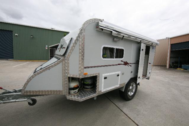

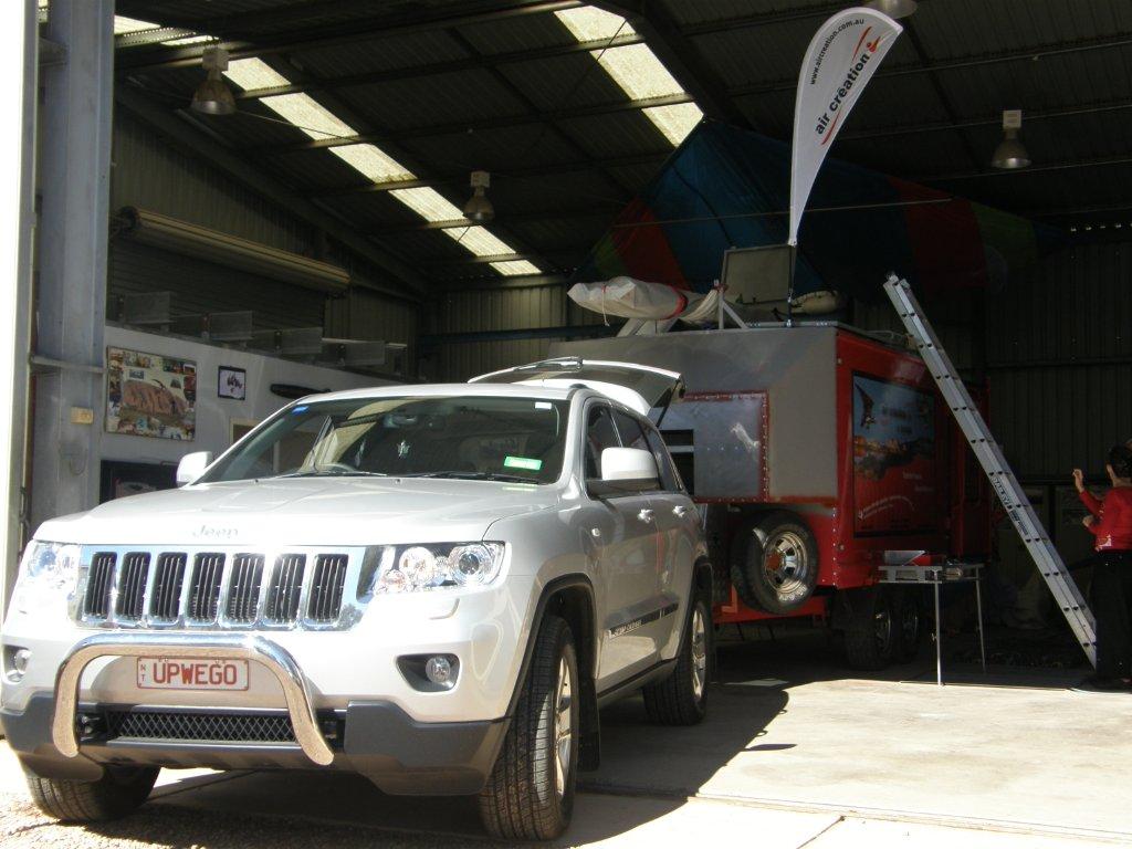

1968382586_TanargLoadedwithnewTrailorMods1.thumb.jpg.0656301be007ca84d6df278b70105c5e.jpg

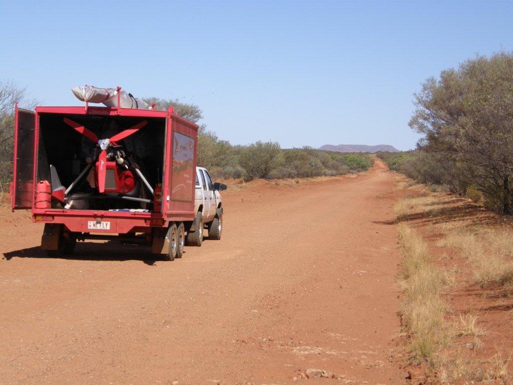

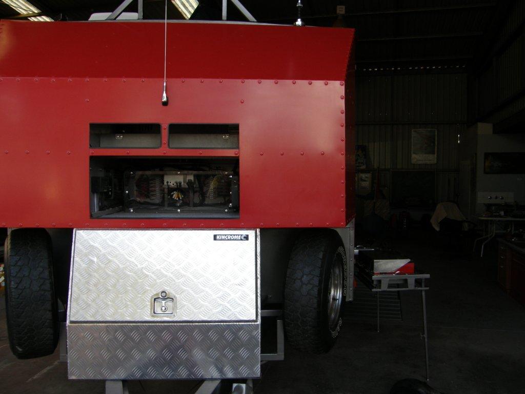

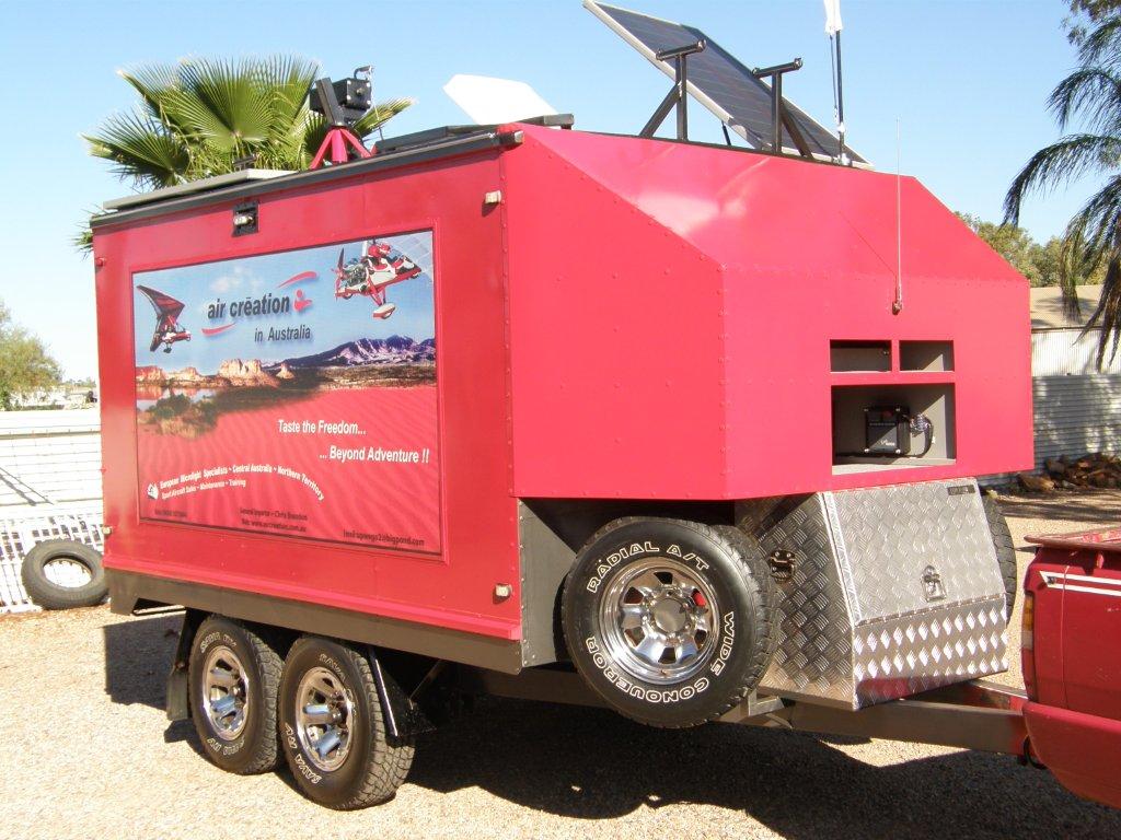

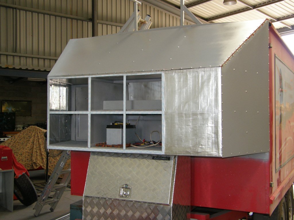

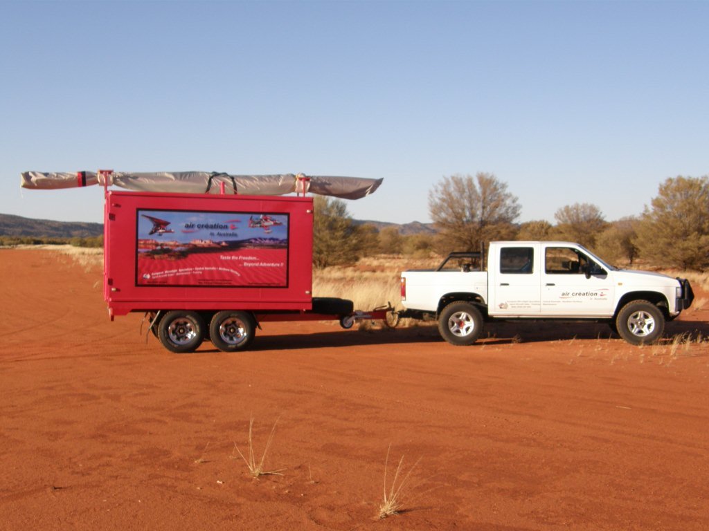

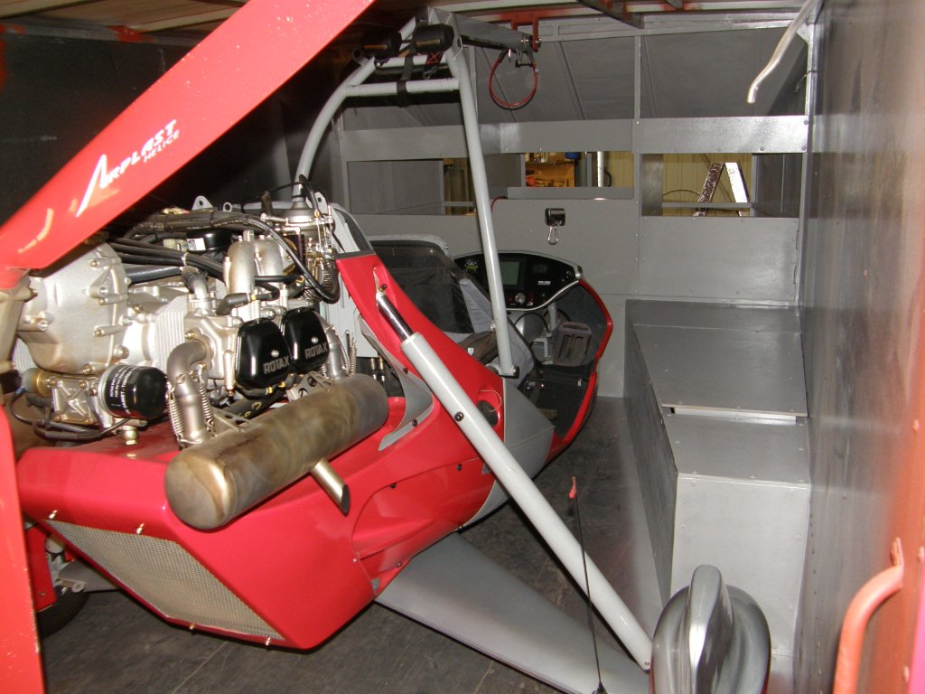

Hi All..trike trailors ..mmm!!
My trailor project has been under construction for about 3-4 years now and it has been a great journey to build to accommodate all those quirks learnt over many years of triking & trailoring..!
Soon its will be all done! Here is a qick peak, and if you want any ideas for yours, just ask!
Primary objectives:
1 No limits in off-road capability for touring Outback Australia.
2 Safe, secure and simple transporting of my Tanarg - one man operation.
3 Versatile, self accommodating and unique - 5/10 day camping without conveniences + family friendly.
We have taken several trips during the osmosis process & all has been good. Modifications, alterations..change of ideas have nutured the design elements of my trike trailor.
Here are few pics prior the final completion, painting and a good trip somewhere out there..!
Smooth flights

1476309810_1OriginalTanargTrailorConcept.thumb.jpg.5e69df8222d74869a6b5b28436b60c39.jpg

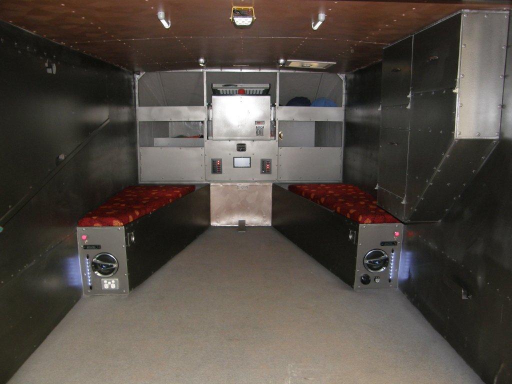

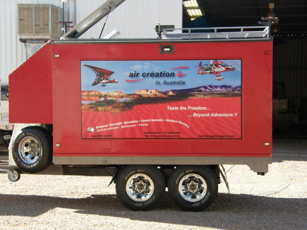

Hi Aaron..many years ago I flew the Birdsville Track from the Airborne Factory, to Thargominda, down the track to Birdsville and onto Wilpena Pound..a very wild experience in an Edge 582!!
As for camping & flying, its all pretty much remote outback, safety is priority, and you may require some permits to enter Native Title Lands.

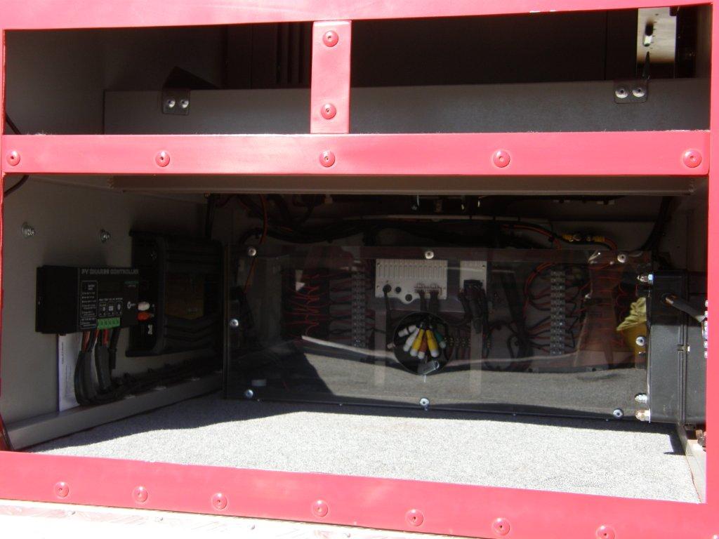

We are very near ready to hit the road with our Tanarg Off-Road Trailor...
The setup allows us to stay outback for approx 7 to 10 days. Solar powered battery storage etc. Should be ready to fly/drive in about 4 weeks.
Smooth flights
Chris
1374956072_TanargTrailorInsideComplete.thumb.jpg.28131872dbef9492eb153ddc00ec4c39.jpg
