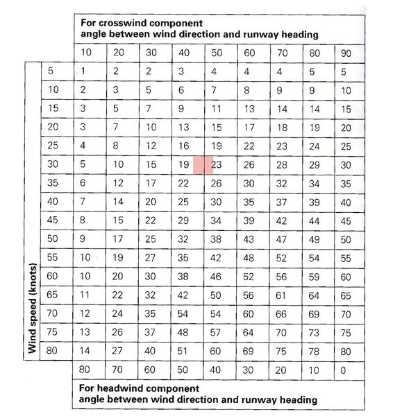

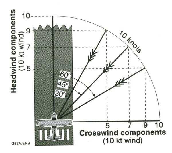

PaulN Posted January 13, 2007 Author Share Posted January 13, 2007 I would land on rwy 18 with a 30 knot wind from SW(225 degrees) this would interpret to a 10 knot cross wind component on rwy 18, which is inside of the envelope for the CT. Chris, My theory books and training say the crosswind component at 45 degrees to runway heading is 70% of wind strength, in this case that's 21kts. See my dilemma? Paul Link to comment Share on other sites More sharing options...

PaulN Posted January 13, 2007 Author Share Posted January 13, 2007 Chris, The images below are from my Aviation Theory Centre manuals. Does this help? Paul Link to comment Share on other sites More sharing options...

Guest David C Posted January 13, 2007 Share Posted January 13, 2007 I always use the " mental arrithmatic " method when I fly . It's easy and accurate . Just multiply the angular difference by 1.5 , this becomes a % of the actual wind velocity . In this case 45 deg X1.5 =70% ( near enough ) . So 70% of 30Kts = 21Kts , this is near as damnit to your X wind velocity . Dave Link to comment Share on other sites More sharing options...
bushpilot Posted January 14, 2007 Share Posted January 14, 2007 Hmmm - But what if it were 80o instead of 45o.. 80 X 1.5 = 120% - which doesn't make sense; so what am I missing? Link to comment Share on other sites More sharing options...
Ross Posted January 14, 2007 Share Posted January 14, 2007 X-Wind for 30 knots at 80 degrees Wind x Sine of (wind Angle) X-Wind = 30 x sine (80 degrees) = 30 x 0.98 = 29.54 knots X-Wind Head wind = 30 x Cos (80) = 30 x 0.1736 = 5.2 knots for 30 knots @ 60 degrees X-Wind = 30 x sine(60) = 30 x 0.866 = 26 knots Head Wind= 30 x cos(60) = 30 x 0.50 = 15 knots for 30 knots @ 45 degrees X-Wind= 30 x sine (45) = 30 x 0.707 = 21 knots Head Wind = 30 x cos(45) = 30 x 0.707 = 21 knots Link to comment Share on other sites More sharing options...

Ross Posted January 15, 2007 Share Posted January 15, 2007 The point about the X-wind is that you do not need to remember the sine of a few angles. The values have been shown to make the point that by the time the wind gets to 45 degrees off the track more than 70% of it becomes X-Wind! Mostly remember how to read the wind sock especially for RAA AC with relatively low allowable X-Wind. Wind socks were probably designed for AC with performaces like that of typical RAA aicraft! Put it another way; you are getting; almost half the wind velocity is X-Wind at a 1/4 of a right angle or 22.5 degrees almost three quarters of the wind velocity is X-Wind at a 1/2 of a right angle or 45 degrees. Sine of the following angles which is the multiplier to convert the wind value to X-wind value. 0 is 0.0 22.5 is 0.38 say 0.4 45 is 0.707 say 0.7 67.5 is 0.92 say 0.9 90 is 1.00 For the Cosine values, the multiplier for head wind, reverse the order of the values So the message here is that above 45 degrees you have more than 70% of the wind as cross wind - read the wind sock for cross wind below 22.5 degrees X-Wind is less than 40% of wind velocity and therefore head wind is closer to wind velocity- read the wind sock Link to comment Share on other sites More sharing options...
