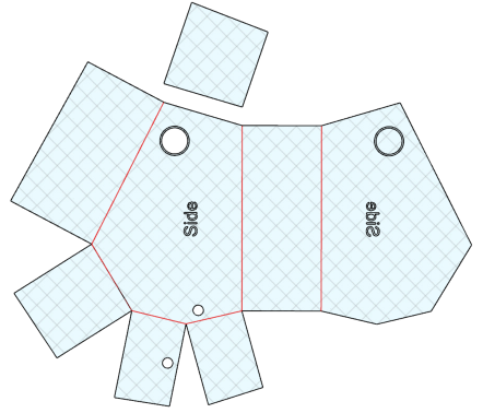

  2. My fuel tank is a weird shape
    Constructing this was proving to be a nightmare, so I created a flat-pack, which looks like this.
    Sketchup can't do this, so I had to do it by hand. I'll cut it tomorrow. Basically, I'll epoxy tape along all folding seams on the inside (red lines), seal the reast of the MDF with epoxy and bend everything together when the epoxy is still in the green stage. The top is a separate piece, which will allow me to reach inside and apply the fillets. Then I'll bond the top on. If this works, I'll commit to 9mm ply.
    This will also allow me to accurately measure the tank's capacity.

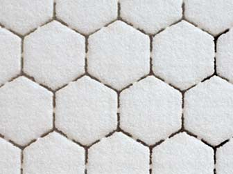

    image.png?u=af344176&access_token=eyJhbGciOiJIUzI1NiIsInR5cCI6IkpXVCJ9.eyJpc3MiOiI0OTM4YThhMmFmNGQ1ODM1Y2JhODNmZmQ0MjU4YmQ4NyIsInN1YiI6IklxOHNTZ3FIM3RsdUNWZjczRU9Sb0o4TVVnYzgwbVd5TnV5MWVweDdOTlkiLCJpYXQiOjE2MjYxNjY4MDB9.gRgERKcSFoWKtxhC898zn3fefW7w050XTG3SxH5reoo&accept=image%2Fpng
    Extremely light, very easy to cut on the router, and simple to laminate with a layer or two of vinylester and glassfibre.  I'll prototype the tank out of cardboard, and then Bunnings plywood before I commit to the actual tank.
