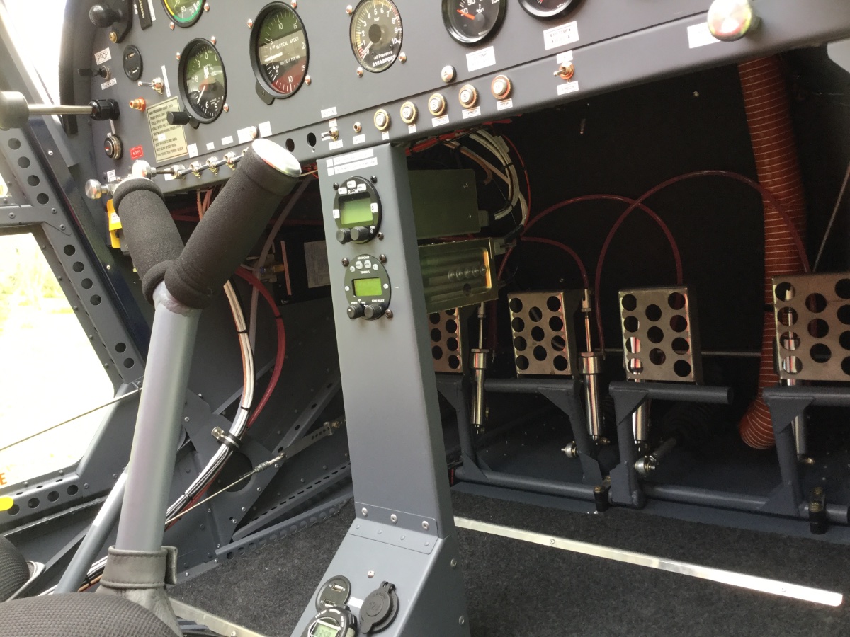

Steve. In addition to my previous comments, here are a couple of pics of the parking brake arrangement in the Savannah S. The yellow lever (LH lower side of instrument panel) operates two “in line” hydraulic ball valves. They are simply a hydraulic lock which, after applying the brake pedals and rotating the yellow lever down, the pressure in the lines is locked in place, and hence parks the brakes. Off the top of my head, I can’t recall if this was an ICP supplied item, or sourced via the (then) Australasian agent. Perry

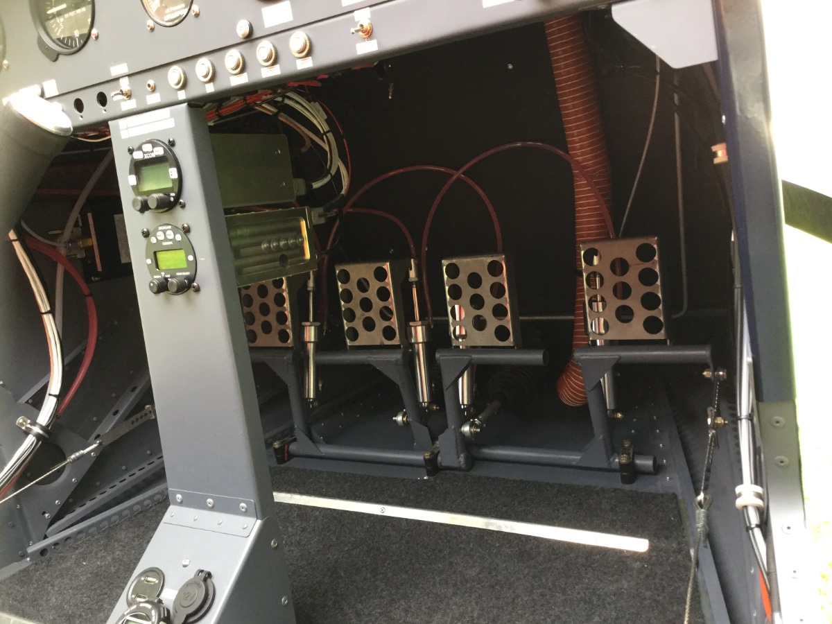

Hi Steve. Here’s a couple of pics of the dual brake set up. I have since removed the passenger side brakes as the factory supplied cylinders/reservoirs leaked, and therefore continually had a pool of fluid sitting on the top. Essentially the second pair is “piggy backed” off the first pair. You need to route/secure the lines so that when the pedals are fully forward, there is nil (or little) chance of hooking your feet in them. Cheers. Perry
