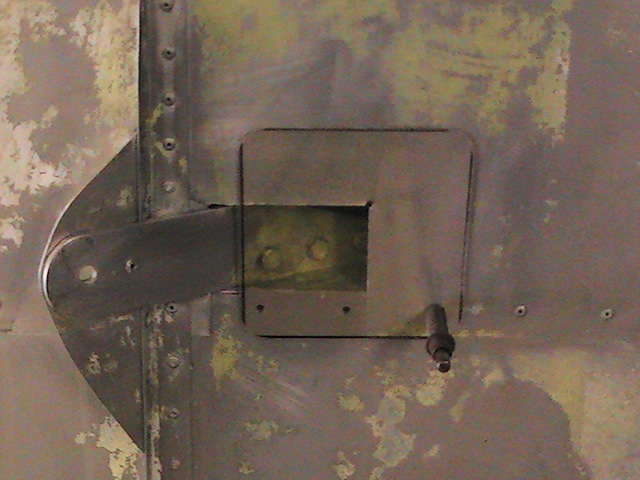

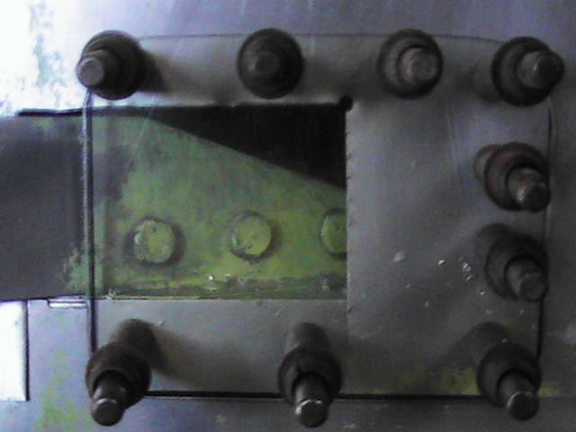

Hi Phil Yes got to get working on the 701 just waiting for my brakes to come, fitted the nose wheel and new Tyre today also made inspection windows for the wing strut attachments just to keep an eye on things inside . After losing Wayne Fisher l am extra cautious on everything now what a waste of a great pilot and great guy shouldn't of happened used to speak to Wayne a lot when l used to build my drifters . cheers Geoff.
