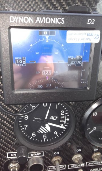

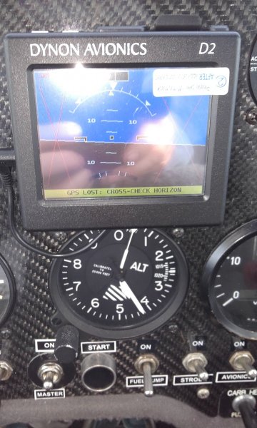

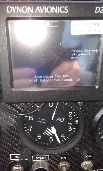

As my first post #20 mentions I have tried the D2 with ext and int antenna. I have run the D2 on trip longer than one hour with me requiring mulitiple power switch ON and OFF cycles to restore funtion. Then I turn it off completely to eliminate distractions and disappointment after about halfway. During flight most times it has lost GPS after only approx 10NM after departing airport airbourne. The GPS failure seems random and sometimes works up to 20-30 at at time, sometime a lot less, but random. I start the trip with a FULLY CHARGED, D2 running on its own battery for diagnostic purposes, to ensure no electrical noise is introduced to cloud the issue. It is too easy for the retailer or Dynon to blame the aircraft electrical system, making noise to interfere. The Garmin G5 is a mounted instrument, the Dynon D2 is portable, I have a Jabiru with 24 reg and too much hassle/cost to install perment version in a aircraft losing value and difficult to sell. I have checked with Jabiru and Ra-aus the only low cost EFIS install option for the J160C is the D10A ($3395 plus acc, plus install). The D2 issue is not new and be also seen with member BJK post #17 with his D2 and the open cockpit Starlet. I could handle loss of GPS but its the screen going BLACK with one line message is the issue. One day if Accidentally stuck in cloud the A.H is what you bought the unit for in the first place. -

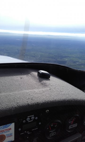

Perhaps this problem is more normal than being reported. In March 2016 I purchased a Dynon,D2, fitted into a Jabiru J160, using external GPS antenna, running its own battery. As we all know the Jabiru is fiberglass and should look transparent to GPS signal when airborne. My iPad running Oz runways works without issue located on the pilot side. During flights even on fine weather days it would lose its GPS position, display the red cross, then after a minute show black screen. I tried moving the ext antenna, to the dash, up high, left side, right side, and using the internal antenna to no avail. Only option was to power off and restart the D2 to make it work again for a random period of time. Then I returned the unit to the agent in Melbourne and it was replaced. The second unit worked sort of better, still losing its position and random intervals. This has become worse requiring many restarts in a half hour flight. Now I will have to go through the process of returning this one. I ponder if these units were only designed for gliders, with no engine or electrical noise. Is it a defect in the D2 unit or some electrical noise the Jabiru makes that interferes with it. Apart from Roscoe, has any other Jabiru owners with D2 units experienced the same issue?
