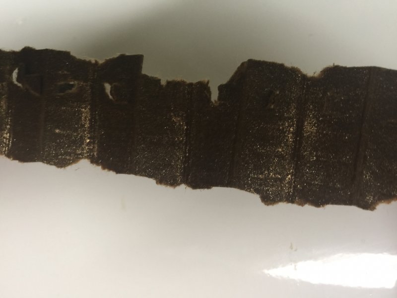

Quick update our heads have been stripped down valves lapped and reassembled ready for fitting soon. On the oil flow into the rocker area .....it does come up the push rod middle . Then it returns via the push rod outer tube . Oil must come in and back out. Otherwise it would heat and lose its properties with time. The brass of course is caught by the filter and the pre strainer in the oil return cannister. But it is being worn off these faulty rocker bushes , therefor it travels through the rest of the engine to get to the filter. The filter reduces the concentration of brass in the engine. There were signs of brass on the cylinder walls ! But it actually wasnt bonded to the wall . What i still cant come to terms with is that a brand new rotax rocker bush is very inexpensive , less than $10 yet someone made up brass ones .... Cant see any sense in that.

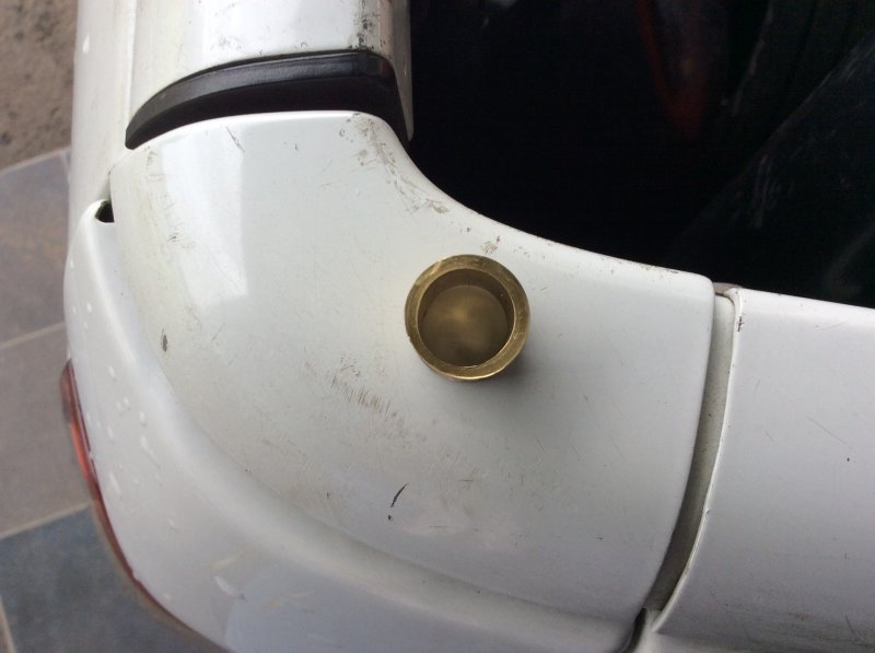

Not one brass bush 8 brass bushes and 7 out of 8 have visible wear. We cant understand the mindset of the person who was responsible ( irresponsible might be better) but there ya go, i have theories on this but i cannot discuss them here. There might be some official investigtion , after all this is a maintenance incident that could have had serious consequences B.
The brass bushes should never ever have been maunufactured and installed ....the brass is too soft in this application. The plastic has a hardness greater than this brass. In effect this has probably saved this engine. Our lab tests of the oil showed copper , extreemly high, zink high and some lead which we can explain. ( av gas on occasions). But we have no steel or other metals related to case hardened bearings , cams or rocker shafts. We have no metals showing in lab report that relates to big end bearing metals. Or aluminium . So all thats been worn is brass. But the fine bits of brass will have entered the hyd lifters. There could be some in the oil galleries , and the oil cooler will have heaps , might need a new one but we have sent it to a company that specialises in internal cleaning of oil coolers ( usually in mining equipent ) they will catch what comes out at each cleaning cycle. We caught this problem early. Although the filter shows a lot of brass the one before showed just a trace so we immediatly saw the trend . The engine was actually running perfectly. Was not using abnormal amounts of oil A credit to its designers. The labs interpretation of the oil samples was invaluable . Yes prob do a 5 hour filter inspection , and send oil to the lab . Then decide on the oil change period when these results come back. On the oil flow the rockers are straight after the filter , so any brass went right through the engine but some did settle in the oil can . Cheers Brian
Hi all and thanks for the comments. The mods were we believe, ( being careful here ) authorised by a person outside the GA arena. And after registered in RAAUS. Doesnt make it less stupid. The lifters are being done for 2 reasons the first is that one was noted to be leaking and secondly the brass will have made its way into the lifters and might cause future issues. Thes brass entered the oil just after the filter exit so it has been carried just about everywhere. Cleaning the oil cooler of brass could be difficult . So the parts required might yet get bigger. We decided to get our local L2 to carry out the repairs . He is very experienced with the 912 series engines. If folks are interested i will do a weekly update ? Heres a photo of the swatch of oil filter showing the brass in it and one of the offending rocker bushes. Note its out of round .

Thanks. Spent today with our L2 and got to bottom of the prob . Without going and pointing fingers..... A previous owner performed a top end overhaul of the engine. Rings valves and rocker bushes. They replaced the rocker bushes with brass not bronze and NOT the rotax plastic ones that should have been fitted. Result was 7 out of 8 bushes are worn to a oval shape. And they were binding as the valves were lifting . Most tight at top dead centre. So it will be quite a parts bill , bushes , rocker shafts , new lifters because there will be brass in them and possibly rings due to brass in the oil . you can see a brassy tinge in the cylinder walls. Thanks Brian
