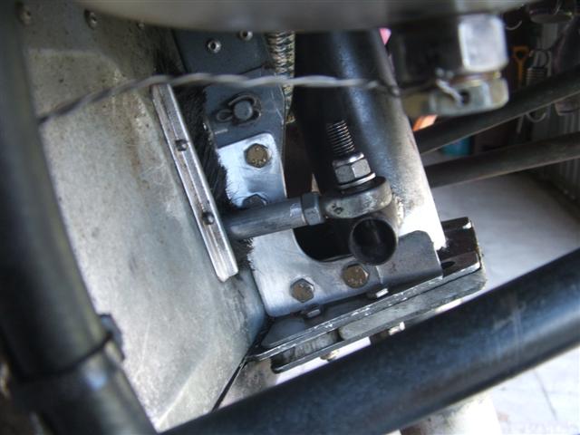

I have found a broken sf282 bracket as part of the nose leg support. See photo. There have been absolutely no hard nose wheel landings, but lots of taxiing on rough strips, 700hrs on the aircraft. There are three layers of metal at this point, so no concern of immediate failure. Conversations on the yahoo Savannah forum indicate that several other aircraft have noted similar breakage. To repair I made up a doubler to bolt to the side of the broken part. I used 2mm (.080) because that is the max thickness that fits against the firewall and inside the lower bolt heads. I used two AN-3 bolts above and two below the break. Increased the width at the narrow point as much as full lock on steering will allow, about double the original width. Much easier than replacing the entire part, and plenty strong. See photo. JG
