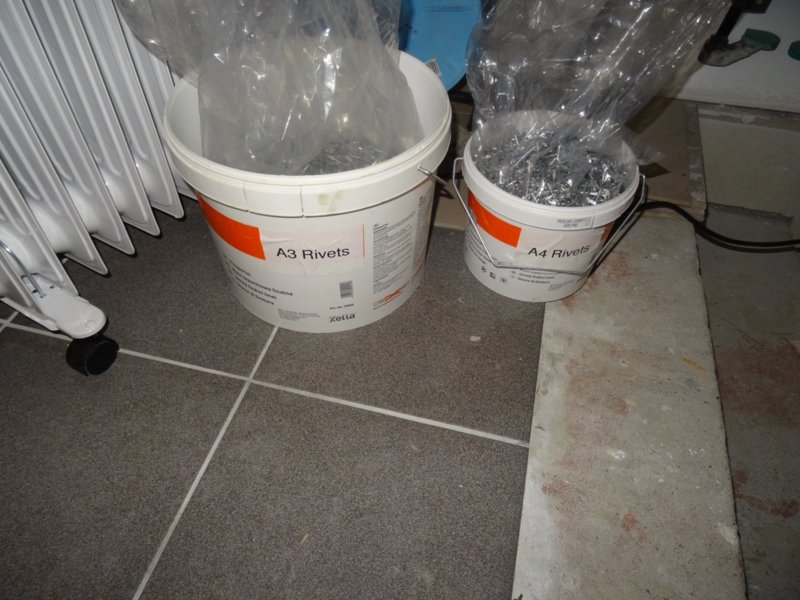

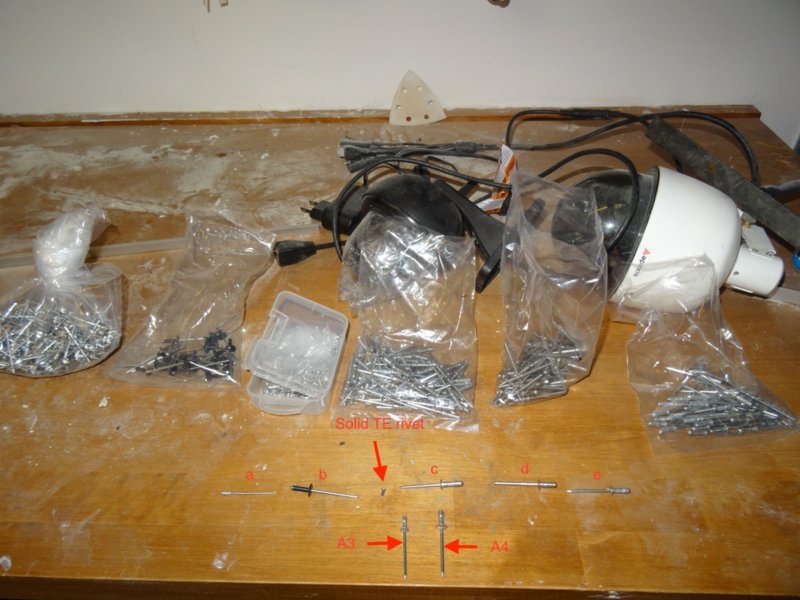

Thanks Ibob, I see what you mean about the threads, they are very confusing. Will leave this one to die and keep the coming home one for the questions. Can a moderator merge them? You are also right that the majority of rivets are the A4(3.1mm) and A5(3.8mm) (I have wrongly marked them up in the picture) there are a smaller bag of A3(2.5mm) marked as "a" in the photo. "b" is a 3.2mm flat head, "c" no idea, "d" flat head A5(3.8mm), "e" no idea

So I have read the instructions and it says there are 3 rivet sizes, but in the box there are significantly more! the picture shows what I got in the kit, can anyone hazard a guess at what a,b,c,d,e are? c and d, I think are the A5's but they are very slightly different. For the fin assembly I need the A5 and flat head rivets for the rudder hinge brackets. Answers on a postcard...
