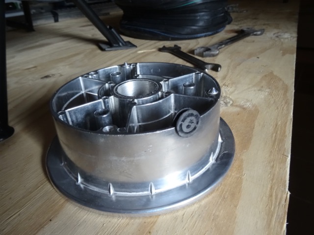

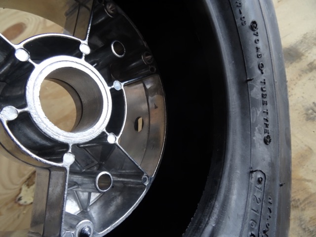

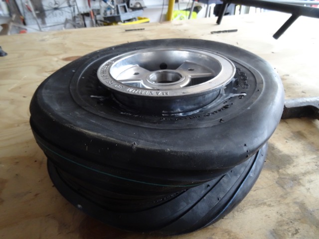

  1. Woo Berringer are VERY nice indeed, however I can't afford them yet. I can see that with plenty of soap and force you could get one side on, but I can't see how the other half would pop out with just the pressure of the inner tube.
  2. Thanks Skee, I think I need some soap
  3. Some pictures, I must be doing something wrong:

  5. Well I know I am doing this wrong by doing things out of order but I thought this would be an easy job and would save some space and prevent parts going astray! I followed the instructions and drilled a new hole on the rim for the air valve 27mm from the edge. then I got the tire and tried to "slip it over the drilled half of the wheel, it goes maybe half way and then is completely stuck. Is there a "knack" to this? I tried washing up liquid but no luck. any advice welcome?

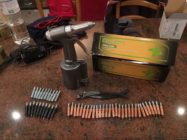

  11. It has been a very long day so I havent had time to update my other posts. So here is what I found in the box when I opened it up. There is a stranger set of pliers (you need to tighten them yourself) 10 silver, ten black and 30 copper clekos, as well as a rather nice looking rivet gun. Wading through the manuel, well the first few pages you need to either buy or make a solid rivet squeezer. I am not so sure that I can find a pair of pliers with a long enough throat for the job so will probably make an order to aircraft spruce and top up the clekos at the same time.
