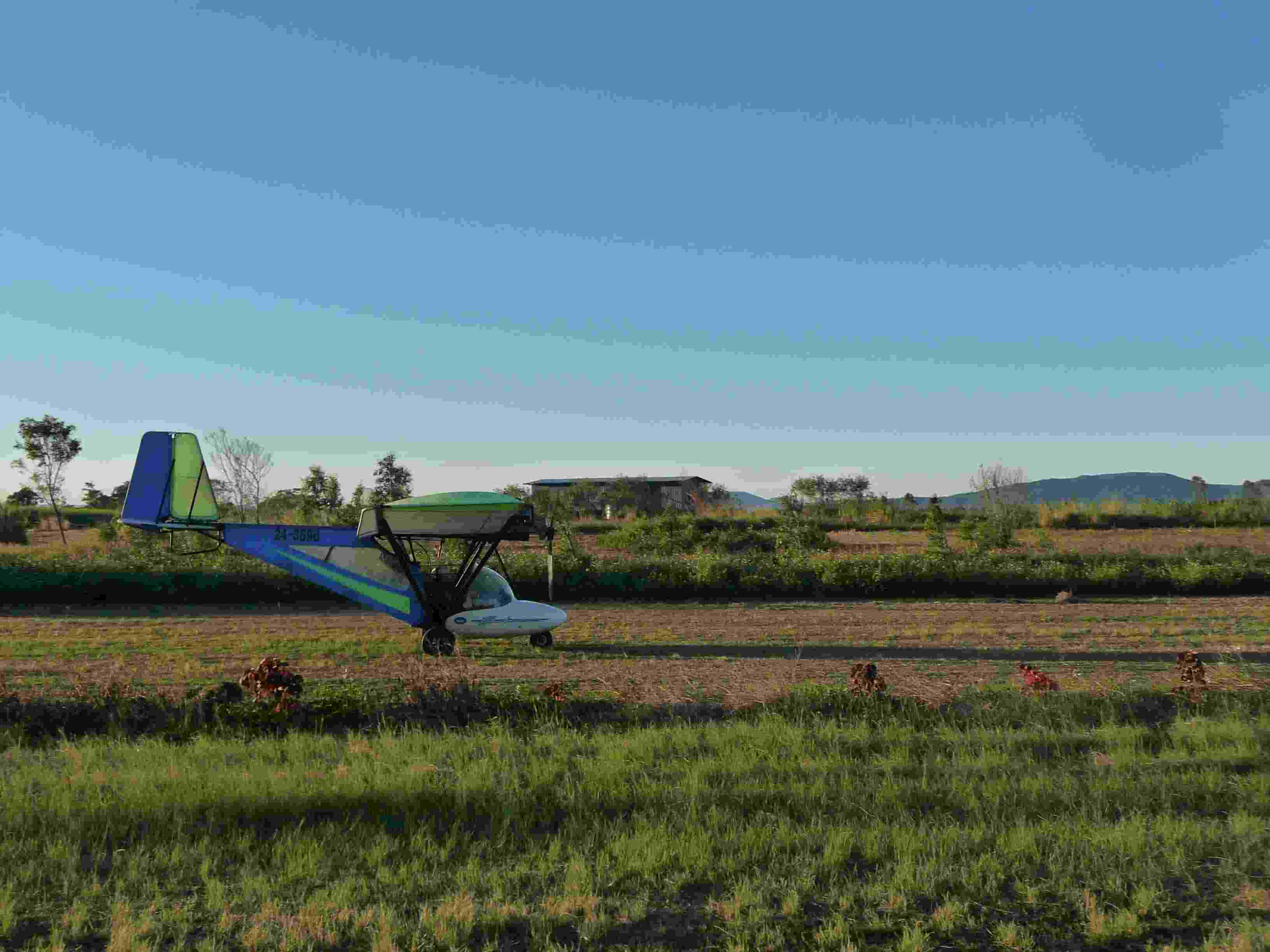

  1. Hi louis If you want to go further afield check out the beaches of north Queensland, lots of long hard packed sand, many with no access other than aircraft or boat! Try to see the movies Charlie and Boots, and On a Wing and a Prayer. Weve discovered the self inflating matresses, 3,5cm thick, (Black Wolf) are surprisingly comfortable, light and pack up very small. Note:- The drifter was assembled on the beach for photograpic purposes only. Cheers Ian

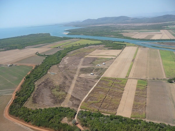

  3. Hi Mike 20 deg 32.8 S, 148 deg 39.1 E. about 7nm SE of Proserpine (Whitsundat coast) airport. 09/27 240m grass strip and 17/35 600m grass strip undulating at the northern end perfect for Savannahs and Drifters!!!!

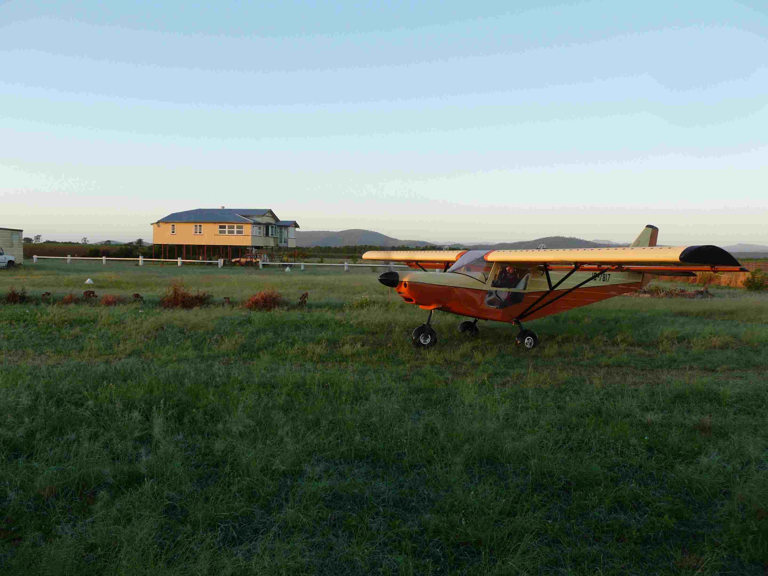

  7. Hi Mark You seem to be cracking along now that you can do a bit each day, before you know it you'll be finished!!! I've just completed the 25 hr test flight period in Cab Sav. The only problems in that time have been three broken exhaust springs, I did have a vibration from the front wheel after take off as it continues to rotate for some time. This was fixed easily with a few balencing weights from a bike shop. So now I'm set for the first trip away to Old Station next weekend. The better half will have a more comfotable flight than the trip to Monto last year in the back seat of the driffter, The cabin heat really does work!!!! Keep up the good work and I'll cxatch you in the air soon. Regards ian

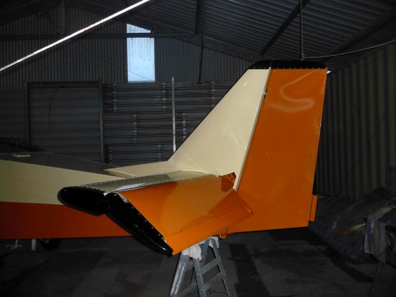

  14. Hi mark I used a full 4 litres of the super etch in which just about everthing was painted with 1 coat, about 3 litres of the primer, one coat on most things, 3 litres of the orange ( 2 litres paint + 1 litre hardner ), 2 coats were needed and 2 litres of the cream and about 0,5 litres of Black. Also used lots of elbow grease!!! I'll try for a photo again soon regards Ian

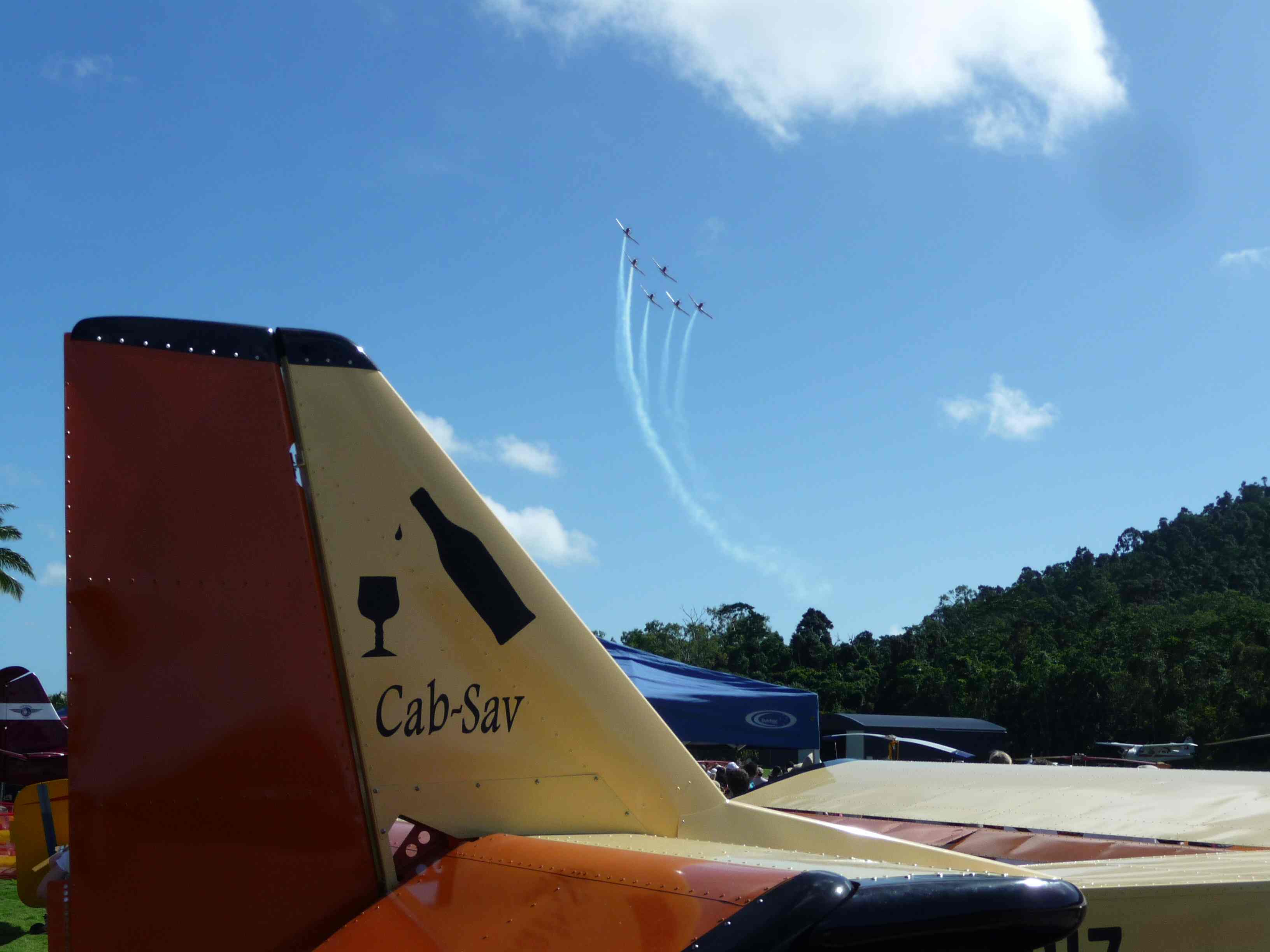

  20. Hi Ross can I book you in for a pre flight on the savannah on the 29 th of april so I can take it for the air show???????[ATTACH]13267.vB[/ATTACH]

  23. Hi mark I've used wattyl super etch primer, followed by epinamel pr 250 primer then polythane AU 625 2 pack topcoat. This is the system that Maj Millard recomended, he works on the seaplanes at shute harbour and its the system they use, some of them have been flying for 70 years aparently and still going strong. As I want to put floats on eventually and live very close to the sea corrosion protection is important. I'll try again for some photos. Ian
