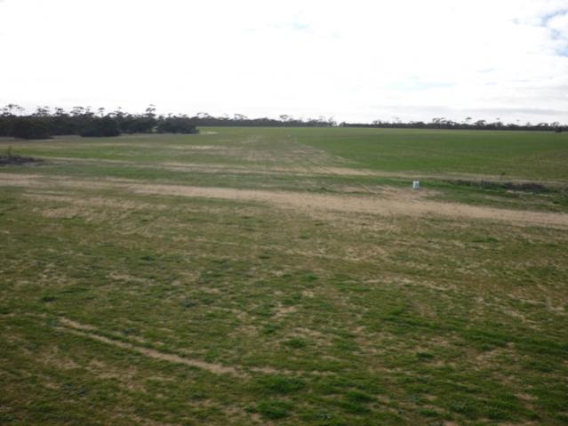

pudestcon Posted May 31, 2010 Share Posted May 31, 2010 G'day Thruster Fliers and others, Ultimately my T500 will have a home at my mates (he likes to be known as Poll) farm (farm name is "Wirraway") where we will obviously have a dirt strip - well 2 strips actually! My question is in relation to technique when doing wheel on landings. My technique as taught is on touch down to 'nudge' the stick forward to pin the aircraft down by reducing the angle of attack. Now it occurs to me that on a dirt strip there is probably more 'drag' from the strip surface which is likely to induce a nose down effect (less angle of attack?) requiring less forward movement on the stick ,or maybe no "pinning down" required at all. Is this something I should consider or am I barking up the wrong tree? Here are some photos of the airfield we will use. Still some work to do but you'll get the idea. Pud Link to comment Share on other sites More sharing options...
Tomo Posted May 31, 2010 Share Posted May 31, 2010 Doing wheeler landings in the Drifter the other day on grass/dirt/gravel strips, you'll still need to check forward in my opinion. Btw, looks like a great area for the strip!:thumb_up: Link to comment Share on other sites More sharing options...

pudestcon Posted June 1, 2010 Author Share Posted June 1, 2010 Yeh Tomo, we think the area is great for an airfield. Nev, Only ever done wheelers both in Drifters and now in Thrusters. Have never been given any instruction on 3 pointers but I recognise the advantage of 3 pointers in getting in to short strips and less strain on the landing gear. Maybe have to learn the technique. Pud Link to comment Share on other sites More sharing options...
