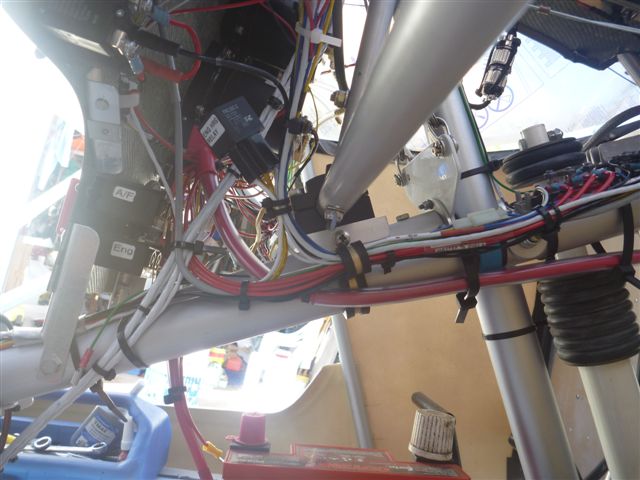

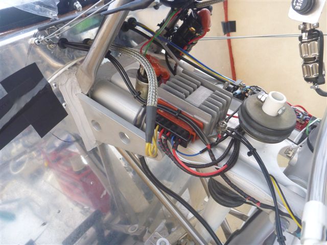

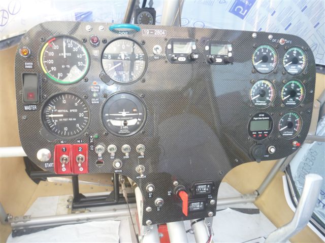

cscotthendry Posted June 27, 2015 Author Share Posted June 27, 2015 Mike: Yes tht's where I mounted it. The socket that I found doesn't mount, it just plugs onto the bottom of the relay. The relay itself had the mounting lug. The socket has the advantage that if you ever disconnect the relay, you won't have to sort out which wire goes where when you replace it. Link to post Share on other sites
Blueadventures Posted June 27, 2015 Share Posted June 27, 2015 Hi Scott Just back from picking up a socket. Went to town today as I needed some more 0.25 fuses for my UMA air switch. When installed it kept blowing fuses. Tried to contact company in USA but no reply todate. Last night when installing the top console piece I removed the airswitch and was about to replace with another brand. While out I set up a c/b and connected to the A and B pin and no short; so opened up the plug on the item end and discovered the A and B contacts were reverse connected from the factory. I'll leave then as is and reverse my wiring to the connection and note the wiring diagram. (That way may be able to exchange if needbe. I expect the unit is ok as the short was before the unit.) I'll post some images when I've sorted it. I'll resolder the pos and gnd wires in reverse and test the airswitch at above 40 kts. Regards Mike Link to post Share on other sites

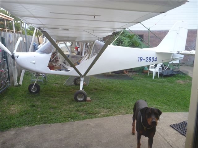

Blueadventures Posted July 4, 2015 Share Posted July 4, 2015 Build is progressing. Should get more done tomorrow. 1 Link to post Share on other sites

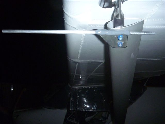

Blueadventures Posted July 4, 2015 Share Posted July 4, 2015 Thanks Scott Some of the fit out is a hybrid; a mix of Gregs, yours, Marks and Steves ideas, plus my experience and other mates and forum info plus of course the kit from Skyranger. Doing the pitot mount and tube fit to night. Trying to fit to alluminium bracket with tie wire and liquid metal; should be neat and strong enough. I'll post an image when done. Cheers Mike Link to post Share on other sites
cscotthendry Posted July 4, 2015 Author Share Posted July 4, 2015 Thanks ScottSome of the fit out is a hybrid; a mix of Gregs, yours, Marks and Steves ideas, plus my experience and other mates ... Cheers Mike That's what's so great about those kits. They allow such creativity and for us all to stand on the shoulders of those who preceeded us. The build looks clean, neat and really slick. A credit to you and you can be proud of it. Link to post Share on other sites

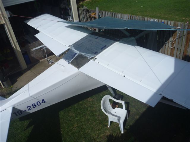

Blueadventures Posted July 11, 2015 Share Posted July 11, 2015 Got the flight feathers on and adjusted today. Ailerons all set and correct, flaps adjusted to neutral position setting and wing tips drilled. Just need to fabricate the trim pieces under wing at the upper door hige to keep the draft out then remove wings ready to take to airfield. A couple of other jobs in the fuse to be done plus fir the upper door hangers for when opened and finalised the wing tank fitup including the fuel feed line and return setup to the tank; but definately chipping away at the final 90%. Cheers Mike 1 Link to post Share on other sites

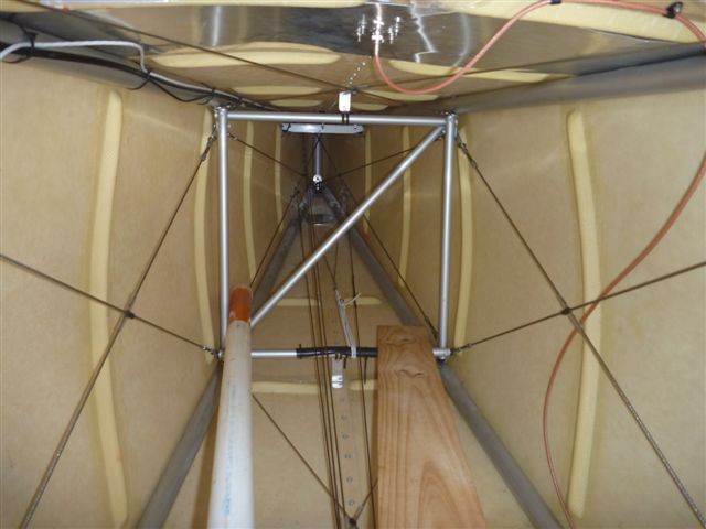

cscotthendry Posted July 11, 2015 Author Share Posted July 11, 2015 Mike: You might get some oil-canning in the belly under the cabin. Greg had it with his and I had it with mine. I put some styrofoam pieces between the angle braces and the belly to stop it. Can't remember what greg did. Something similar I think. 1 Link to post Share on other sites

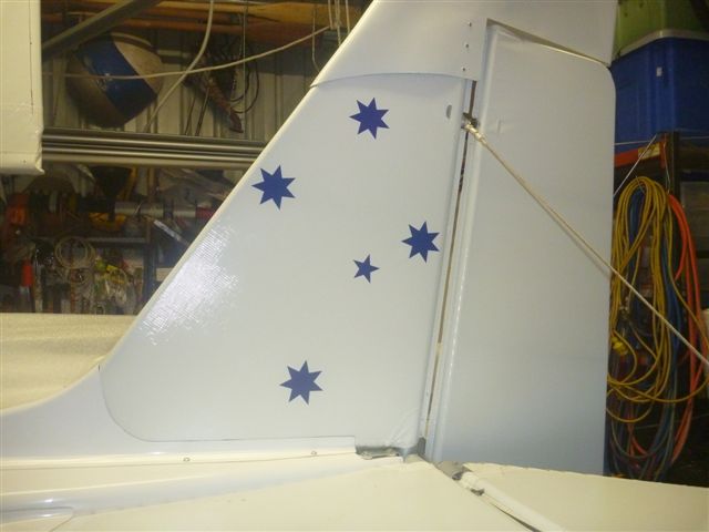

Blueadventures Posted July 24, 2015 Share Posted July 24, 2015 Mike:You might get some oil-canning in the belly under the cabin. Greg had it with his and I had it with mine. I put some styrofoam pieces between the angle braces and the belly to stop it. Can't remember what greg did. Something similar I think. Jazzed up the fin with a bit of colour, fitted supports for the fuse f/g skin and tied the rudder bungee. I'll get the fuel tanks and fit the door latch holders this weekend and run the fuel lines, etc. Got a replacement oil temp gauge on the way. Should have the prop spinning next weekend. Approaching the finished stage slowly. Looking forward to having the seat belts in and the seat covers on; as then it'll be looking good. Cheers Mike 1 Link to post Share on other sites
eightyknots Posted July 29, 2015 Share Posted July 29, 2015 Jazzed up the fin with a bit of colour, fitted supports for the fuse f/g skin and tied the rudder bungee. I'll get the fuel tanks and fit the door latch holders this weekend and run the fuel lines, etc. Got a replacement oil temp gauge on the way. Should have the prop spinning next weekend. Approaching the finished stage slowly. Looking forward to having the seat belts in and the seat covers on; as then it'll be looking good.Cheers Mike Lovely! 1 Link to post Share on other sites
cscotthendry Posted July 29, 2015 Author Share Posted July 29, 2015 Jazzed up the fin with a bit of colour, fitted supports for the fuse f/g skin and tied the rudder bungee. I'll get the fuel tanks and fit the door latch holders this weekend and run the fuel lines, etc. Got a replacement oil temp gauge on the way. Should have the prop spinning next weekend. Approaching the finished stage slowly. Looking forward to having the seat belts in and the seat covers on; as then it'll be looking good.Cheers Mike Mike: Love the SC on the tail. Nice touch. Can't wait to hear you've flown it and see some pics of it in the air. I would have liked to come up and video the first flight for you like I did for Vince, but I'm plainly planeless :-( If you can wait till late September though ... 1 Link to post Share on other sites

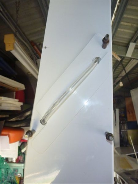

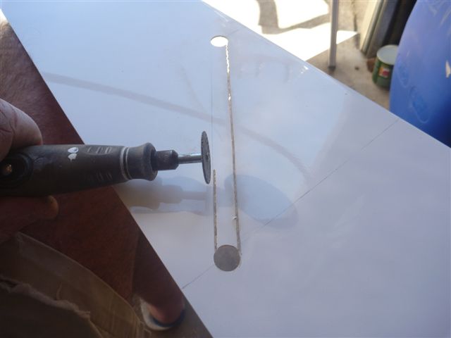

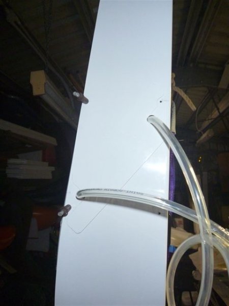

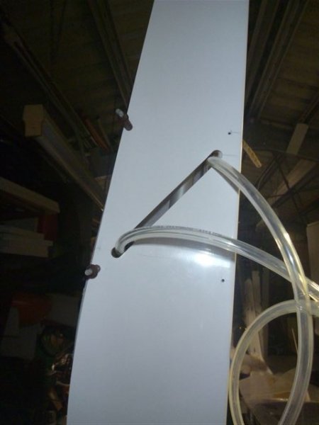

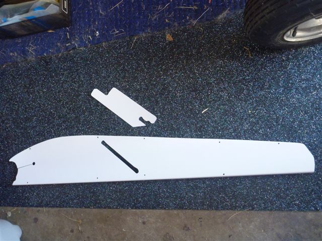

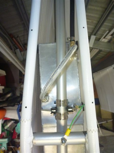

Blueadventures Posted August 8, 2015 Share Posted August 8, 2015 Cut out for the visual wing tank fuel content tube and the backing piece to mark the quantity graduations onto. Link to post Share on other sites

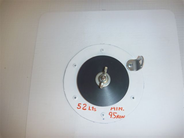

Blueadventures Posted August 16, 2015 Share Posted August 16, 2015 Finished off the tanks, fuel content sight tube, filler (included a earth connection as my mr funnel setup has an earth wire I made for the skyfox filler) and root trim fitup today. Getting things ready to start the engine next Saturday. Cheers Mike 2 1 Link to post Share on other sites
Blueadventures Posted August 16, 2015 Share Posted August 16, 2015 Finished off the tanks, fuel content sight tube, filler (included a earth connection as my mr funnel setup has an earth wire I made for the skyfox filler) and root trim fitup today. Getting things ready to start the engine next Saturday. Cheers Mike Link to post Share on other sites

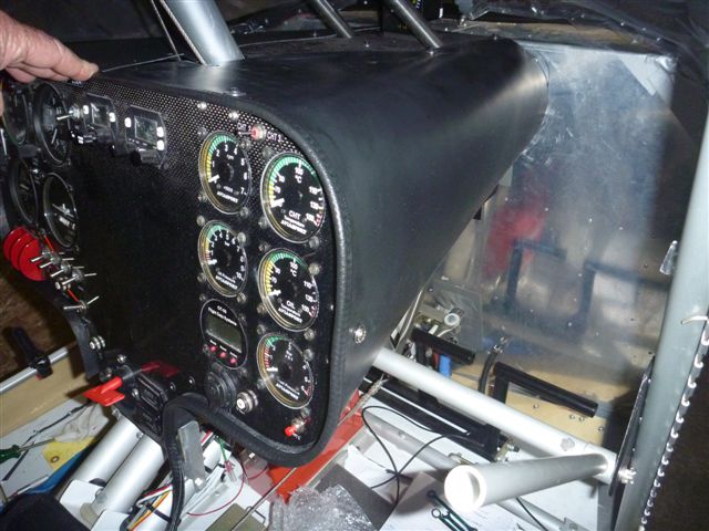

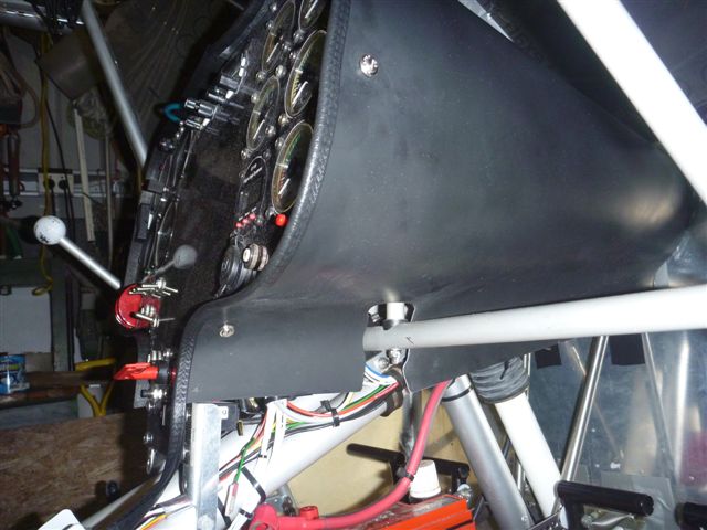

Blueadventures Posted August 20, 2015 Share Posted August 20, 2015 Did some finishing off on the binacle sides. Decided to re do the side and lower screws on both sides with camlocs so any time I have quick easy access and it works well. Also gave the sides a sand and painted in matt black. Looks ok, so may leave them that way rather than cover with vinyl or carpet to save some weight. 1 Link to post Share on other sites

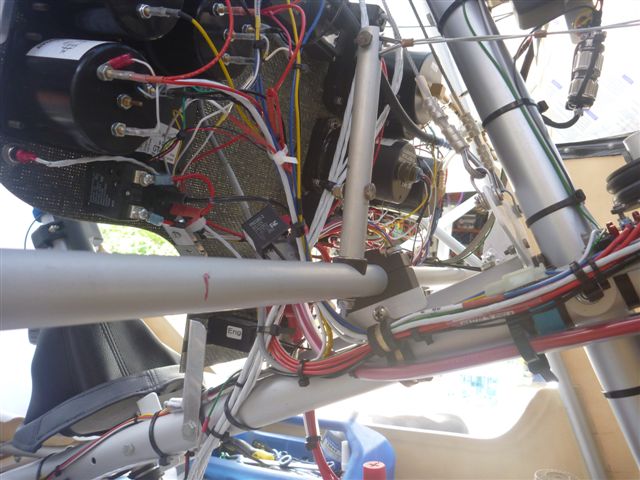

cscotthendry Posted August 20, 2015 Author Share Posted August 20, 2015 Mike: It's hard to tell whether you have it or not from the pictures, but some kind of brace on the throttle tube where the cable control arm attaches would be useful. That long crosswise tube will flex more than you'd expect under the force of pulling the two carbies and the friction in the cables. Link to post Share on other sites
Blueadventures Posted August 20, 2015 Share Posted August 20, 2015 Mike:It's hard to tell whether you have it or not from the pictures, but some kind of brace on the throttle tube where the cable control arm attaches would be useful. That long crosswise tube will flex more than you'd expect under the force of pulling the two carbies and the friction in the cables. Hi Scott There is a brace mounted off the right main tube. You can see it a bit it these images just on the other side of the post. Its mounted to angle aluminium and attached with one of those WDG metal band pipe clamps. I'll adjust the choke and throttle on Saturday and should give her a start on Sat or Sunday. Regards Mike Link to post Share on other sites
