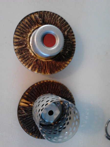

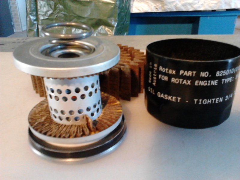

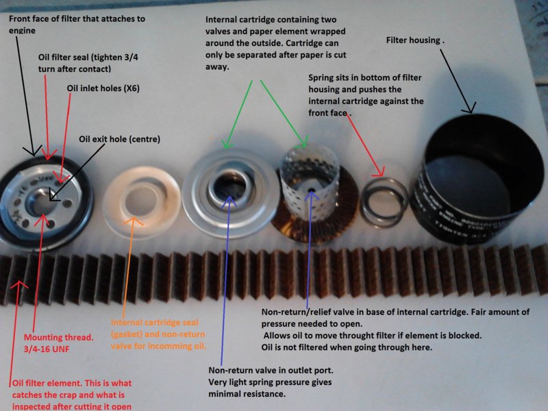

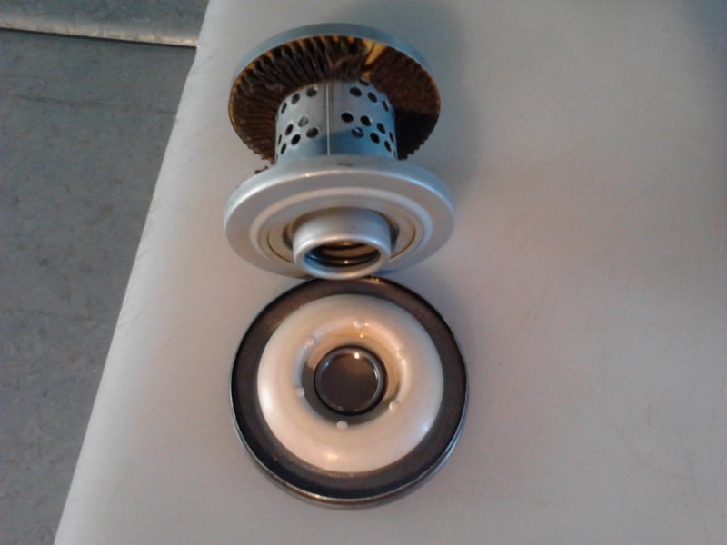

Downunder Posted July 30, 2014 Share Posted July 30, 2014 Thought I'd make something up for those that are interested in the internals of the Rotax oil filter. I may not have some of the terms exactly correct, but hopefully get some info across without being flamed too hard... Parts are named and described basically as I see them.... 3 Link to comment Share on other sites More sharing options...
Dieselten Posted August 2, 2014 Share Posted August 2, 2014 I like it. About all that's missing is the area of the filter element, the pressure at which the bypass-valve operates and the porosity of the element-material. Just goes to show the complexity in a modern oil-filter. Well done and nice pix too! Link to comment Share on other sites More sharing options...
Downunder Posted August 2, 2014 Author Share Posted August 2, 2014 I like it. About all that's missing is the area of the filter element, the pressure at which the bypass-valve operates and the porosity of the element-material. Just goes to show the complexity in a modern oil-filter. Well done and nice pix too! Thanks for your comments....... As far as the bypass pressure goes, I could drill a hole in in the valve and connect a "fish scale" to get the spring tension and measure the diametre of the hole. As pressure=force/area, (spring tension =force & dia of hole = area) it can be calculated I guess . What would stuff me up is the units of measurement and converting them to a correct psi/kpa/ bar readout. I'm willing to supply the figures if someone wants to do the calculation? Is there and interest in me doing a Jab filter? Whats the number? I take it the 4 and 6 cyl are the same? Link to comment Share on other sites More sharing options...

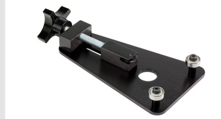

nomadpete Posted August 2, 2014 Share Posted August 2, 2014 What tool do you use to open the filter? Link to comment Share on other sites More sharing options...
DrZoos Posted August 2, 2014 Share Posted August 2, 2014 Filter cutter...like a big can opener Link to comment Share on other sites More sharing options...
DrZoos Posted August 2, 2014 Share Posted August 2, 2014 Like this but there are lots of others Link to comment Share on other sites More sharing options...
nomadpete Posted August 2, 2014 Share Posted August 2, 2014 Thanks. I'll have to get myself one of those. Link to comment Share on other sites More sharing options...
AVOCET Posted August 2, 2014 Share Posted August 2, 2014 Thanks. I'll have to get myself one of those. Just been checking e bay $ 100 from Dandenong vic looks good ,billet ally . Link to comment Share on other sites More sharing options...
DrZoos Posted August 2, 2014 Share Posted August 2, 2014 Or for the cash strapped make your own from a can opener http://www.bobistheoilguy.com/forums/ubbthreads.php?ubb=showflat&Number=3078586 1 Link to comment Share on other sites More sharing options...
