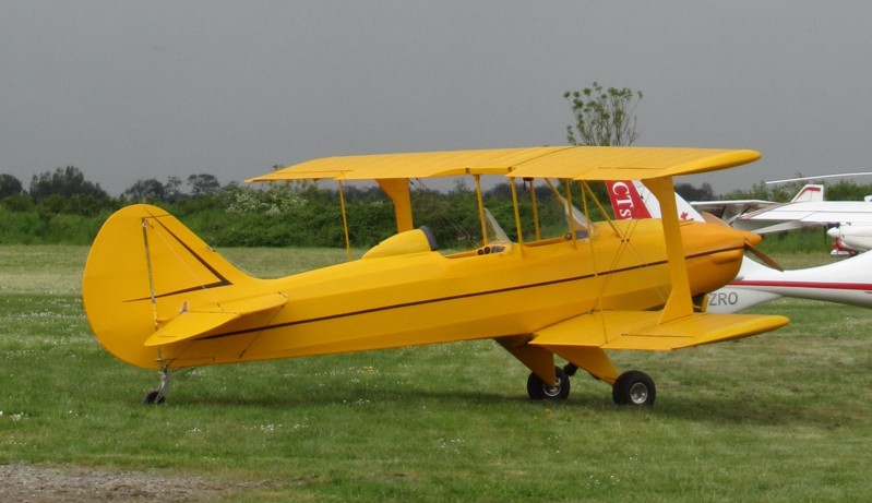

Interestingly, one of the members at our club in France is just completing the paperwork to register his Sherwood Ranger, which he has fitted with the new D-Motor from Belgium. Hats off to the engine manufacturer, they recently contacted him and offered to swap his version 1 engine for the new updated version after he's done 50 hrs on it. That will give him an extra 15HP to play with :)
[ATTACH]15033[/ATTACH]
