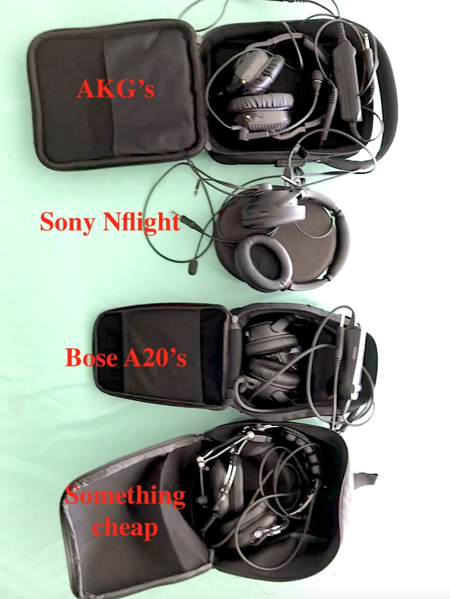

My setup is
Microair M760 http://www.microair.com.au/products/25/M760-VHF-Transceiver-Q
Side by side seating.
I normally fly with the AKG https://www.akg.com/support/AV100.html
They don't make them any more I find them way more comfortable than the bose A20's
My Partner wears the A20's she thinks these are more comfortable than the AKG's
I also have the Nflight mic paired with Sony 1000-xm3's because I did not buy the Nflight pro it is hard to get the volume to match with the aviation headset it runs a lot hotter (louder) I use it when flying solo because the ANR in the Sony's kills both the aviation headsets and they are way more comfortable. If I had the Nflight pro I would use this setup as my main headset.
