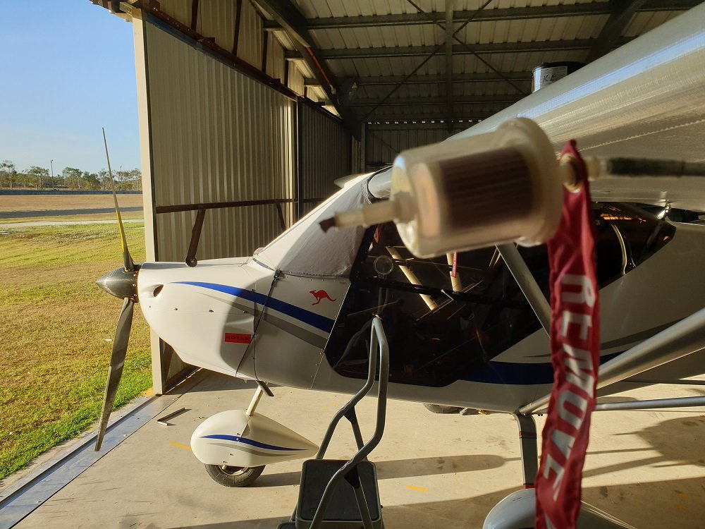

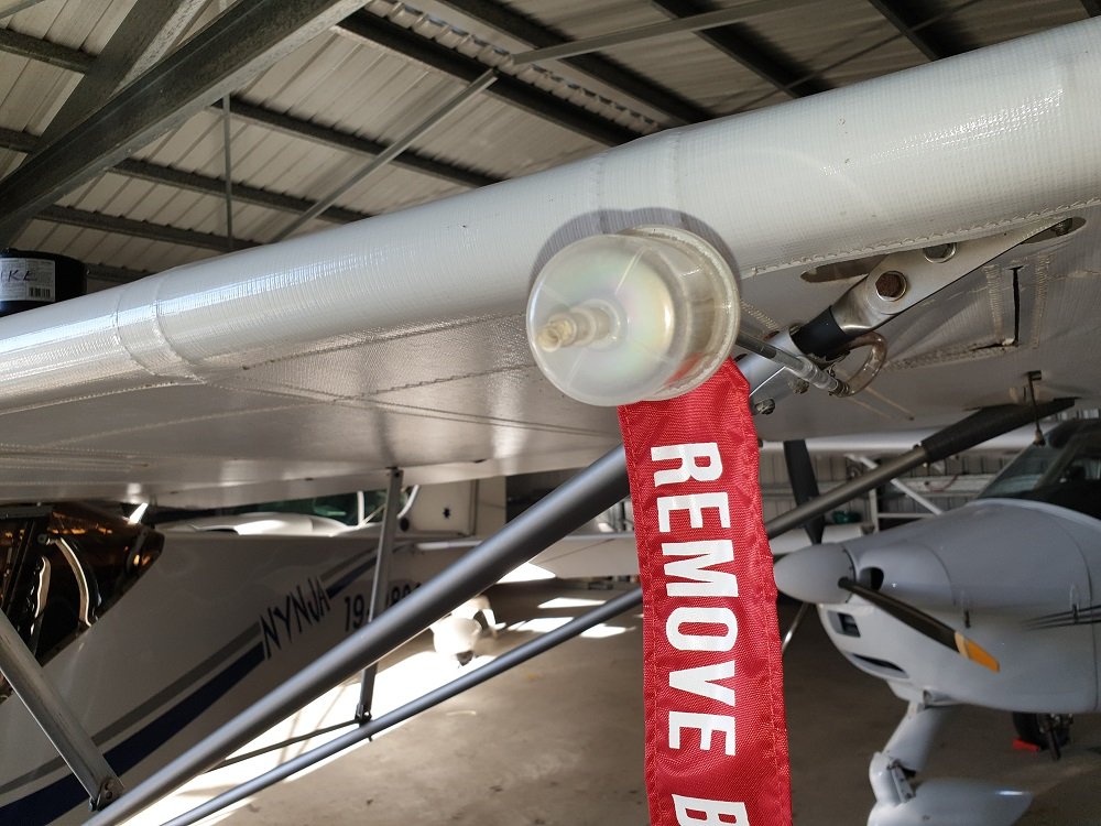

Blueadventures Posted November 26, 2020 Share Posted November 26, 2020 7 hours ago, 408059 said: A couple of years back I had an engine outage over the Southern NSW costal range. Insects had nested in the fuel vent unbeknownst to me and not picked up in the DI. Wasps were what the LAME thought. The fuel system was gravity fed with not a lot of head pressure. The engine continued to operate until the vacuum overcame the head pressure and the engine was starved of fuel. Nothing I tried could get the engine started again. Had it not been for the height I used to cross the ranges, together with and good LD of the aircraft and no propeller spinning, I was looking at a river landing. Instead I made the airport with sufficient height for a planned circuit. Now all vents and tubes are covered with breathable fabric and are part of my DI. Steve I use filter elements for the pitot and two fuel tank vents that way the mud wasps can't get in. You can see a mud wasp started to build onto the filter outlet in the pitot image. gets some questions and comments when other pilots see them but they work; got the pitot idea from camps / courses at Kingaroy Gliding club. 1 Link to comment Share on other sites More sharing options...
