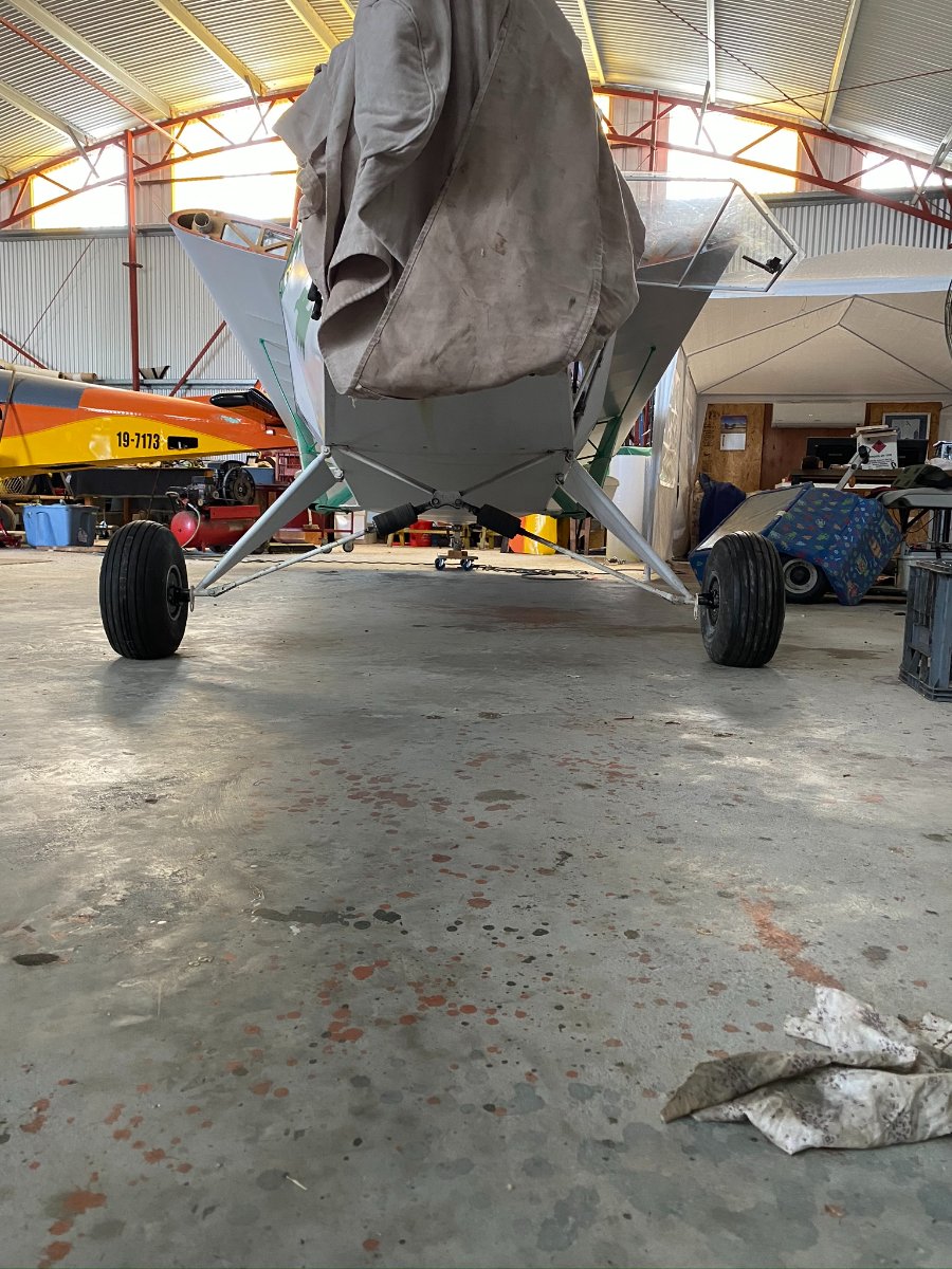

jackc Posted February 8, 2021 Author Share Posted February 8, 2021 1 hour ago, Thruster88 said: I don't know anything about Aeropup but an acquaintance had a U/C collapse on one when the tension rod failed at a welded tube to lug joint. It appeared that most of the weld had been ground off to make it look pretty. My problem is, the legs are not symmetrical even though the manufacturing jig has allegedly not changed. My aircraft was ground looped by a previous owner as was subsequently repaired with a replacement leg, which has different camber and toe out that is visually obvious. I am working on getting another leg or have it repaired. Link to comment Share on other sites More sharing options...

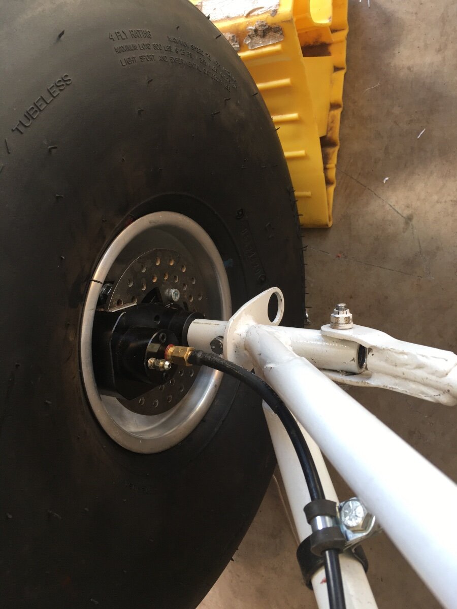

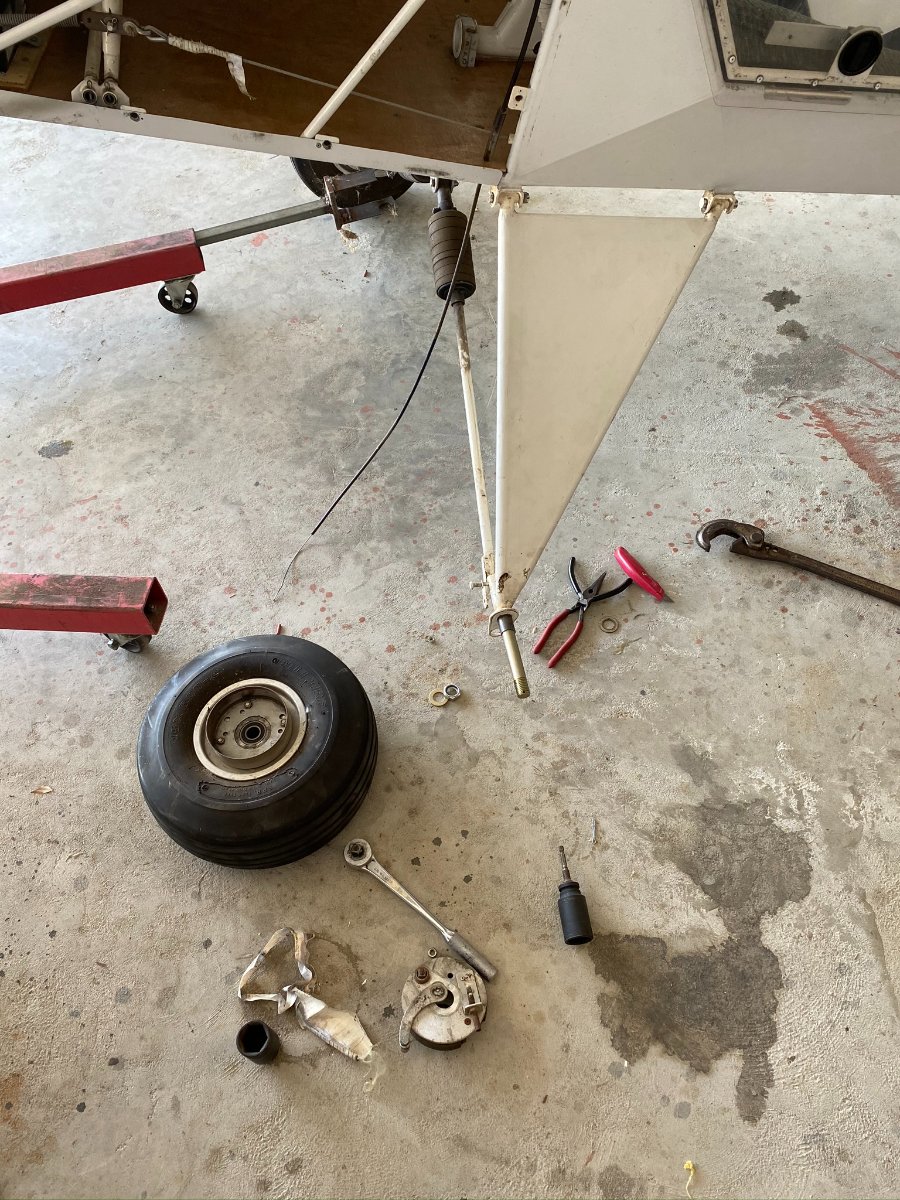

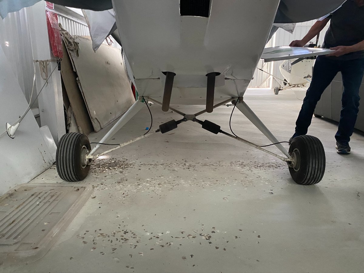

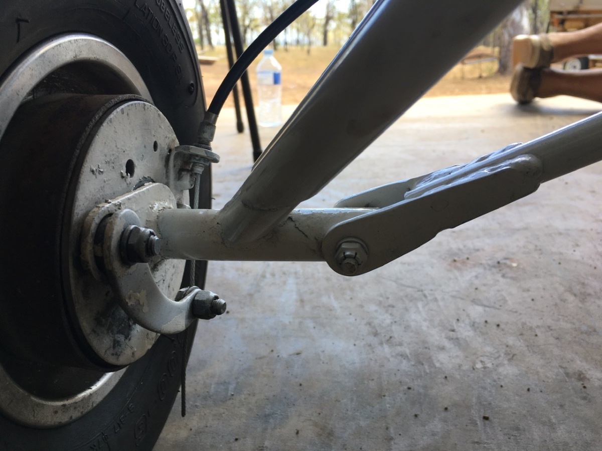

Mikey_C Posted February 23, 2021 Share Posted February 23, 2021 Best I could do remotely, I can take better photos in a few days if required. Link to comment Share on other sites More sharing options...
jackc Posted February 23, 2021 Author Share Posted February 23, 2021 Thanks for pics, see you are fitting a disc brake kit, too. I have a Black Max one to go on but I need to sort out my existing problem. Aeropup are making me a new right side leg to match the replacement they fitted to the left side that they replaced when the previous owner ground looped the machine. Link to comment Share on other sites More sharing options...
Mikey_C Posted February 23, 2021 Share Posted February 23, 2021 Yeah I used Blackmax as well, good little setup. I'll let you know how well it works as soon as I know. Link to comment Share on other sites More sharing options...

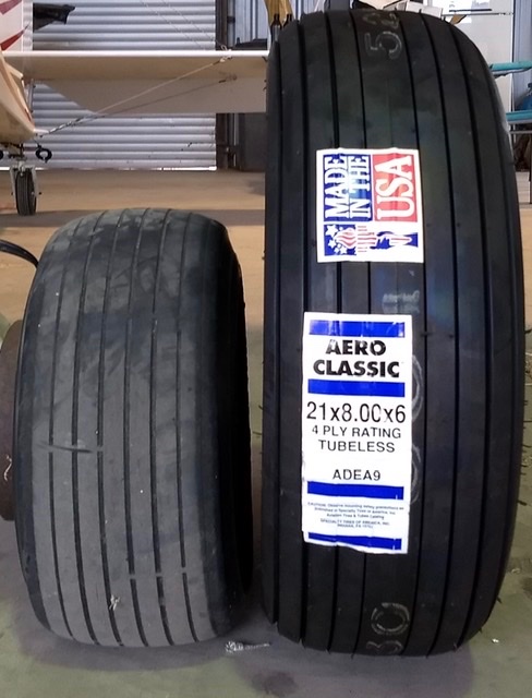

jackc Posted February 23, 2021 Author Share Posted February 23, 2021 Thanks! Once I get my current problem sorted then I can look at doing mine......have to get my 21” tyres too 🙂 Link to comment Share on other sites More sharing options...
Mikey_C Posted February 23, 2021 Share Posted February 23, 2021 Aero classics? Link to comment Share on other sites More sharing options...
jackc Posted February 23, 2021 Author Share Posted February 23, 2021 1 Link to comment Share on other sites More sharing options...

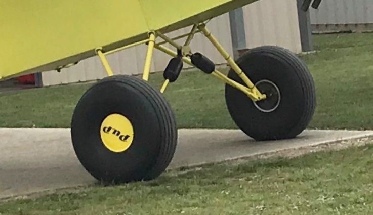

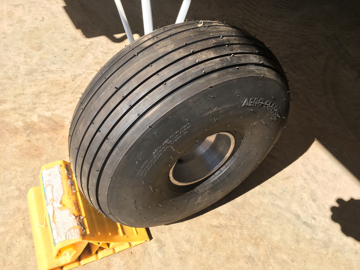

Flightrite Posted September 21, 2021 Share Posted September 21, 2021 Here jackc this is a good combo if you still have yr Aeropup 1 Link to comment Share on other sites More sharing options...

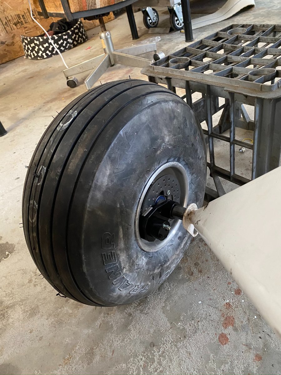

jackc Posted September 21, 2021 Author Share Posted September 21, 2021 Here is mine 🙂 2 Link to comment Share on other sites More sharing options...
