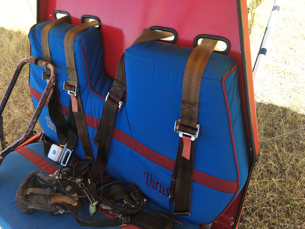

jackc Posted October 12, 2021 Author Share Posted October 12, 2021 1 hour ago, Kyle Communications said: There is a sensor you can buy pretty cheap Jack that you could put on the outide of your tank..a couple of them for levels to bring a LED on. a small bargraph with 3 or 4 of them for fuel levels..they are ultrasonic so pass through almost any material https://www.aliexpress.com/item/32623722632.html?spm=a2g0o.productlist.0.0.507a366bZDhcxh&algo_pvid=37fd848d-728b-4e0c-a17b-dce9c9cee751&algo_exp_id=37fd848d-728b-4e0c-a17b-dce9c9cee751-5&pdp_ext_f={"sku_id"%3A"59376291433"} Thanks Mark, I have to fit something as the clear tubing cannot be seen from cockpit, only on the ground. Link to comment Share on other sites More sharing options...

jackc Posted October 12, 2021 Author Share Posted October 12, 2021 Nev, the clear tube is sandwiched in the middle between the tank and rear cockpit wall, hard enough to to see on ground looking at it. Would have been far better towards one end of the tank. Link to comment Share on other sites More sharing options...
