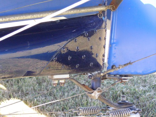

M61A1 Posted October 22, 2012 Share Posted October 22, 2012 I have these from a fly in... don't know whose aircraft, maybe of use. I would recommend (although the factory didn't do it) using a good quality epoxy primer on both the doubler and fuselage, and maybe some sealant in between for good measure. I am in the process of rebuilding a drifter, and everywhere there is stainless or steel against aluminium, there was dissimilar metal corrosion. Link to comment Share on other sites More sharing options...

USADrifter Posted October 22, 2012 Author Share Posted October 22, 2012 Thanks for posting the close up photo, that is a help! Link to comment Share on other sites More sharing options...
