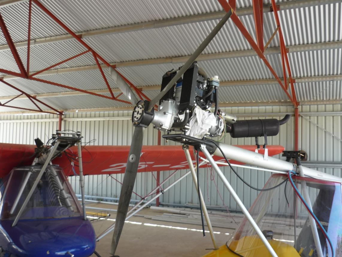

pudestcon Posted October 19, 2010 Author Share Posted October 19, 2010 After looking at the prop today I reckon a coat of clear lacquer will do the trick. Here's a photo of the prop - what do you think? Pud Link to comment Share on other sites More sharing options...
tvaner Posted October 19, 2010 Share Posted October 19, 2010 I'd be surprised if a light coat of ArmorAll wouldn't bring that up as new Pud. Link to comment Share on other sites More sharing options...
pudestcon Posted October 19, 2010 Author Share Posted October 19, 2010 I'd be surprised if a light coat of ArmorAll wouldn't bring that up as new Pud. OK tvaner, That's what I'm gonna try then. I'll let you know how I go. Thanks Pud Link to comment Share on other sites More sharing options...
JG3 Posted October 19, 2010 Share Posted October 19, 2010 That's a Brolga prop, and this is how I had mine painted for years. No problems. Just clean the blades thoroughly with turps then scrub with a jex pad and paint. Keep the paint as thin as possible. Balance by spraying more coats of clear laquer on the lightest blade. If you've already tried ArmorAll then the paint won't stick at all...... Link to comment Share on other sites More sharing options...

Pilot Pete Posted October 21, 2010 Share Posted October 21, 2010 It should'nt really matter what type of polish or cleanersd you use. If you do any painting you should give the area a wipe down with Prepsol or other simular wax/grease/silicone remover. I have used this for years on all surfaces including composite that has had grease,oil silicone,bug guts and all manner of polishes rubbed into it and it does a great job of removing it. Even after sanding you should use it as a lot of sandpapers have silicone on them. Link to comment Share on other sites More sharing options...
