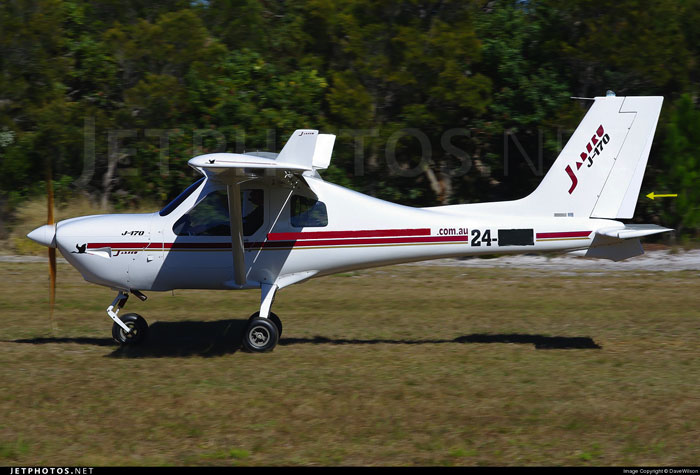

Also, has anyone got any input as to the reasons for the modification - it was suggested that it may be due to a lack of rudder authority in certain situations. I'm battling to understand how an increase in the fixed fin area will address this, normally that is done to increase directional stability in one or more phases of flight or even to assist in spin recovery. I'm referring here only to the new ventral fin, I follow the flap modifications.
This is what was stated in the bulletin by Jab:
"fitting a larger ventral fin improves the aircraft’s directional stability – the pilot’s rudder inputs are fewer and smaller in all modes of flight".
When I spoke with them this week, they stated there was two reasons 1. Directional stability needed to be improved throughout the flight modes 2. Under server testing, during full power stalls, this modification assisted in spin recovery and provided better authority.

Thanks Vev, that explains things - I suspect part two may explain the mandatory part, as one of the earlier posters pointed out many aircraft have had new fins and strakes added, not uncommonly to address spin recovery.
Spin,
Spot on ... I had a good look at Cessna 162 Skycatcher at Oshkosh last year (2010) and they too had added a huge ventral fin along the fuselage which extend to form part of the rudder bottom ... the Cessna sale chap said it was added to assist spin recovery, following some flight test problems. Interesting to note the 162 I looked at had had a significant tail strike.... The Cessna's tail is only about 2 feet off the ground... at least the Jab has a good air gap to support the ventral.

Reading the post from the beginning, I was getting the impression Jabiru was trying to correct a crosswind handling problem and wanting better rudder authority.
But as I read on I find it's more to do with low speed directional stability.
Either way, the answer is more more vertical surface area, BUT, having more fixed area will lesson control authority as mention by SPIN.
One thinks the better correction would have been to produce a bigger rudder, and retro out to owners on the same swap deal (they could keep all the old rudders for the 160's).

The ventril fin is huge. Tail strikes are going to happen with great frequency. Ours has not had the mod done yet, but will be returning to the factory (at the owners expense) to have some repairs done on cracking repairs. hhmm...and will be getting the mods installed then.
The 170 does get 'fluffy' at slow speeds and the first axis to suffer is the longitudinal. without doubt.
I am no engineer so I can't comment on weather the fin will dampen that, but i would imagine it would be more prone to weathercocking, and reduce the effectiveness of the rudder, ie, you will need MORE rudder to keep it straight once it starts an excursion offline.
Anyway, Jabiru must have good reason to make the mod mandatory.
