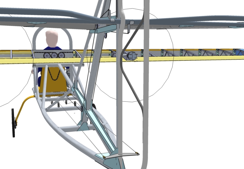

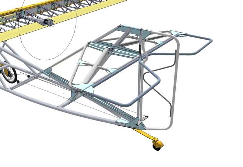

Tomo, don't suppose you can get me a photo of the elevator linkages. I'm having trouble in finding a neat way to do it on my cruciform tailplane. Not wanting teleflex/morse type cables due to weight.

This is what I've come up with. The 'up elevator' cable has to go through the horizontal stabiliser. Doable but might have to add a through tube in case I ever need to change the cable. The 'down elevator' cable is outside all other structures.

Thanks Adam, photos received. Like I said above, I don't want morse type cables due to weight. I will put up photos if anyone else wishes to see them, meantime....099_off_topic.gif.20188a5321221476a2fad1197804b380.gif
