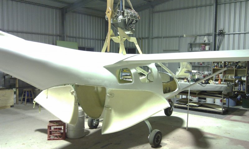

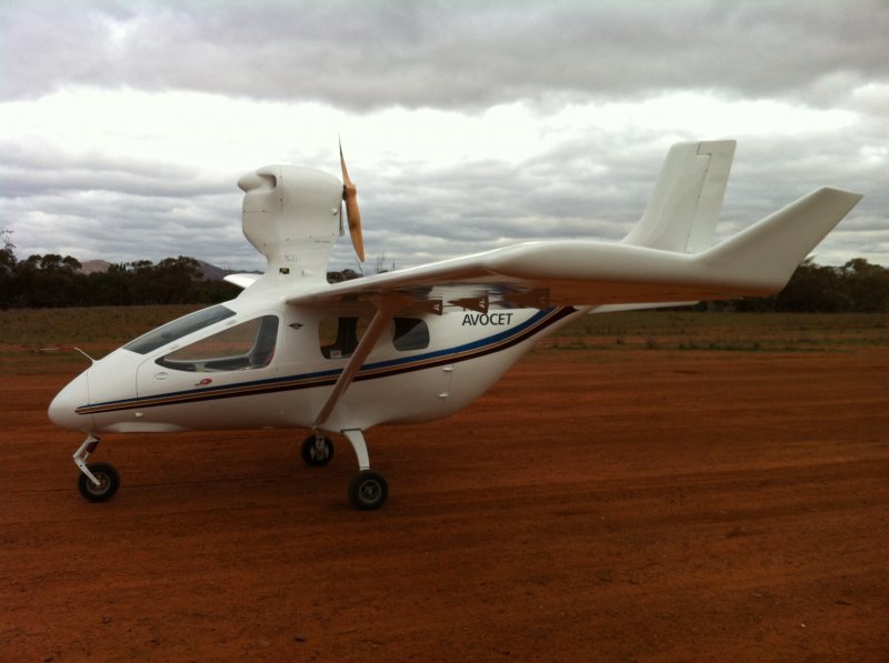

deadstick Posted June 23, 2013 Author Share Posted June 23, 2013 Mike your lucky to be still with us, amazing that you got out of that and well done for pushing on and rebuilding it. That's my Avocet , designed and built by yours truly ,check put the thread "Avocet flys again "[ATTACH=full]22800[/ATTACH] Link to comment Share on other sites More sharing options...
AVOCET Posted June 23, 2013 Share Posted June 23, 2013 That's my Avocet , designed and built by yours truly ,check put the thread "Avocet flys again "[ATTACH=full]22800[/ATTACH] Cargo doors open up , clam shell Jaby wings 250 made the winglets , fuse,vertical stab. Has duel sticks , centre throttle ,sky view , 3300 liquid cooled multipoint injection ,and fuel injected throttle body , 30 amp altinator mounted from the vac. spline , jaby alt as backup 62" prop ,cruise 105 kts. I had to make 25 moulds for the fuse ect.ect Flys great , easy to land . It looks like a Catalina when it lands . Hope to make an amphibious version soon Ill be flying to aust fly in September at narromine Cheers Mike There's some info on the web : google "Mike Sharples avocet " I'm up late to , slept in to late this morning ,it's raining here , for a change! Link to comment Share on other sites More sharing options...
