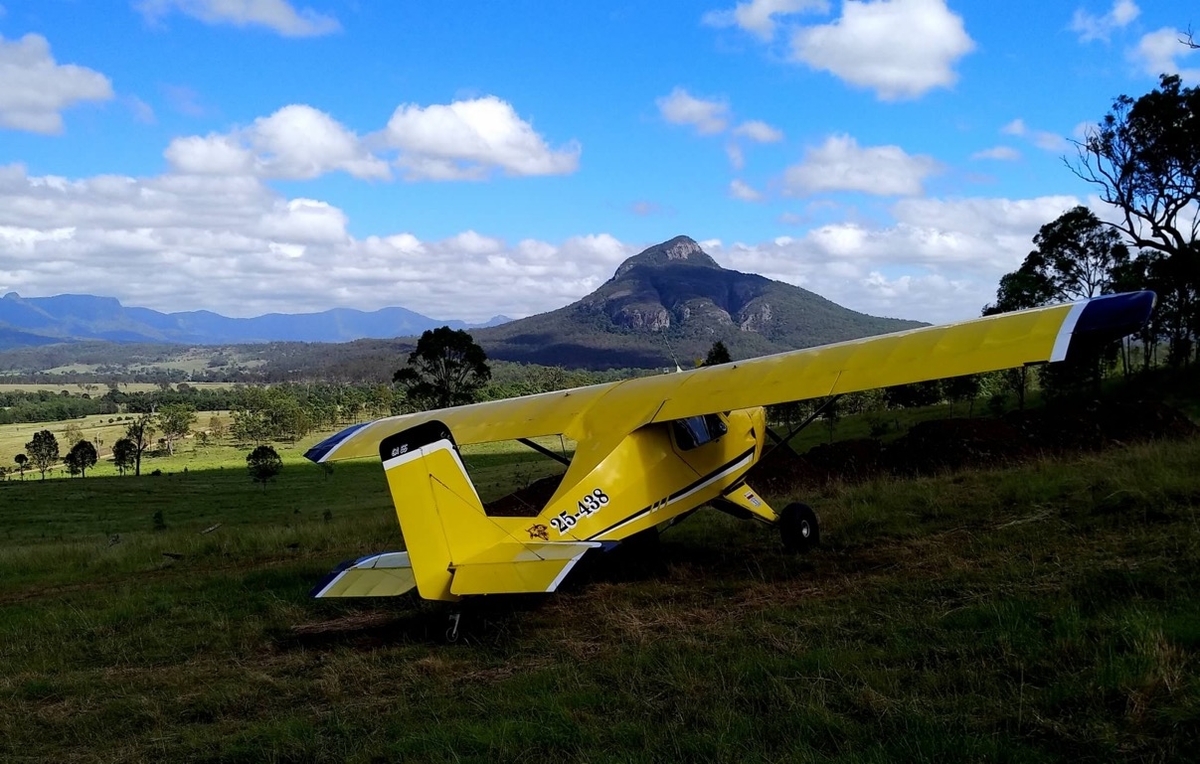

I probably wasn’t clear. The rego painted on the side of his airplane was something like 19-438
when I asked why it was only three digits he said it began (or ended, can’t remember now) with a zero so it didn’t have to be painted on. My question is- if his rego was 19-0438 is it the case you can paint the zero on if you desired?
Also, which is it that you would only
need 3 digits? 0438, or 4380? If the latter then I don’t have to worry because the number I’m hoping to get ends with a zero, not begins with a zero
Until tech manual 4 the leading 0 was not required to be displayed so 25-0125 could be 25-125
and in addition before tech 4 the 10- did not need to be displayed so 10-0125 could be 125 on the airframe.
all of this changed with tech 4 with no leading 0 exemptions and a requirement for 10- display. BUT all aircraft on the register at the date of tech 4 got grandfathered rights to display but you could choose to comply if you wanted.
And if if you were one of the one airframes registered in 95-10 after the removal of display requirements in the ops manual but before they corrected the errors in tech 4 on display you have no obligation to display ANY rego marking on the airframe and that right was grandfathered.
