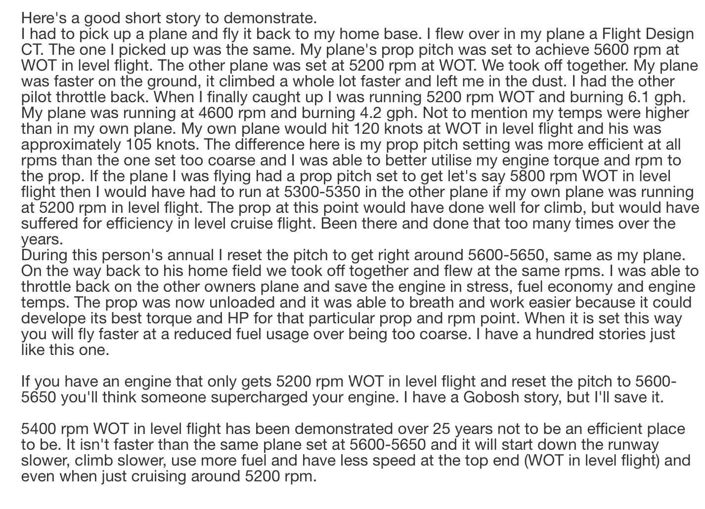

Mike Gearon Posted February 27, 2020 Share Posted February 27, 2020 They have a good cruise speed at 105 kts if you want and stall is 35 kts. Vision from the cockpit is very good. Empty weight is in the 290kg area. The Rotax 912 100hp is a good choice of engine. I’d be interested in RPM for 105 kts. I found this article by Roger Lee on the ultralight forum. I’d expect you’d be talking a similar 5600rpm for the 105 knots. That’s enough. I’d been thinking a bit slower. More Foxbat A22 speed. Interested because I have an interest in a Skyranger and haven’t managed to see or fly in the plane yet. I was in the Phillipines flying ultralights and a Brit who has a flying school back in England was really enthusiastic about Skyrangers. Made me feel like it was well and truly the right decision. Link to comment Share on other sites More sharing options...
Blueadventures Posted February 27, 2020 Share Posted February 27, 2020 Hi Mike I follow R Lee's advice about rpm. Mine was 5,580 (just under 5,600) 105 is S&L WOT. Perhaps post in Skyranger forum for a contact for Victorian owners of Nynja's and ask for a fly. If ever in Mackay give me a call. I'm a convert to Nynja, have 218 hours and no issues and throughly enjoy flying her. Will be awesome kit build at 600kg. All new kits are 600 kg except for undercarriage that is still to be approved. They report just finishing the testing of the new Swift variant. Then I expect the undercarriage will be tested and approved to 600kg. Cheers and thanks for question. 1 Link to comment Share on other sites More sharing options...
Downunder Posted February 27, 2020 Share Posted February 27, 2020 I follow Rogers engine/prop set up advice also... .. 1 Link to comment Share on other sites More sharing options...
