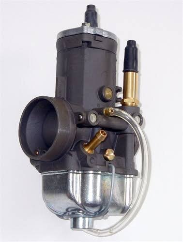

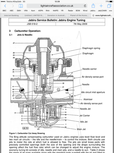

Old Koreelah Posted August 24, 2020 Share Posted August 24, 2020 Can someone please point to a good drawing of the Bing used on the Jab ?. .. 1 1 Link to comment Share on other sites More sharing options...
