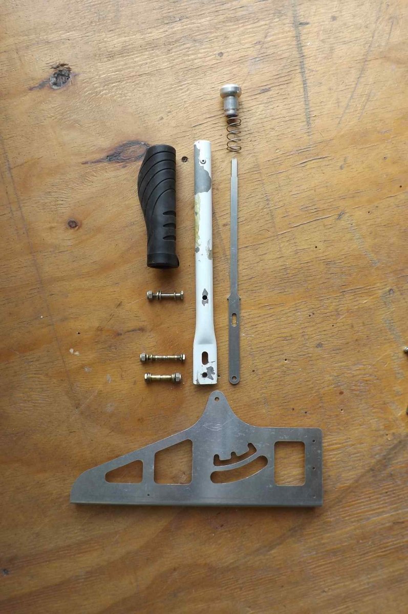

Kyle Communications Posted Thursday at 11:58 PM Posted Thursday at 11:58 PM My solution was as you see the 2 videos. The first was to change the stick position for mechanical advantage then I added another slot to give roughly 5deg then 15deg then the original 30deg of flap. I didnt modify anything other than just the 2 new side plates for the bracket. All the bushes and parts that move were all original. IBob's puts the stick a bit closer to the floor than mine. I sold about 50 sets of the brackets. I havent made anymore because the cost of getting the 1.6mm 6061 sheet from the 2 suppliers in Australia then freighted to Brisbane was getting crazy. I think that it would be fine though to use the 2024 T6 or even marine grade alu would be fine for the brackets. After some discussions with aircraft LAME and pro builders the 2024 would be well strong enough 1 3
IBob Posted Friday at 12:50 AM Posted Friday at 12:50 AM Hi Mark, I'm pretty sure that ICP made a similar adjustment to the stick pivot point. I think the problem emerged with the adjustable seats, not only can we sit further forward, but we are now sitting higher. My kit was dated Dec 2014. Here is a pic of my ICP handle, and beside it the ICP bracket that came with my kit. And the full flap position appears to have their stick vertical. 3
