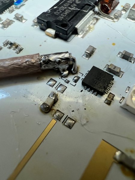

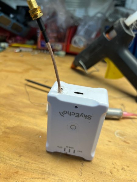

Kyle Communications Posted December 11, 2023 Share Posted December 11, 2023 I have installed a external antenna to mine and it increases its rx and tx range at least by twice using a external antenna. You have to make a pigtail as there is not enough room inside to install a antennea socket on the case. You need to remove the miniture coax connector on the pcb and carefully attach the good quality coax to the correct pads and of course anchor the coax inside with neutral cure silicone or similar. Of course you do this at your own risk and also your local countries rules. But it allows you to go to a proper ADSB antenna. It works but you still need the SE2 on the dash for the GPS signal 2 1 Link to comment Share on other sites More sharing options...
